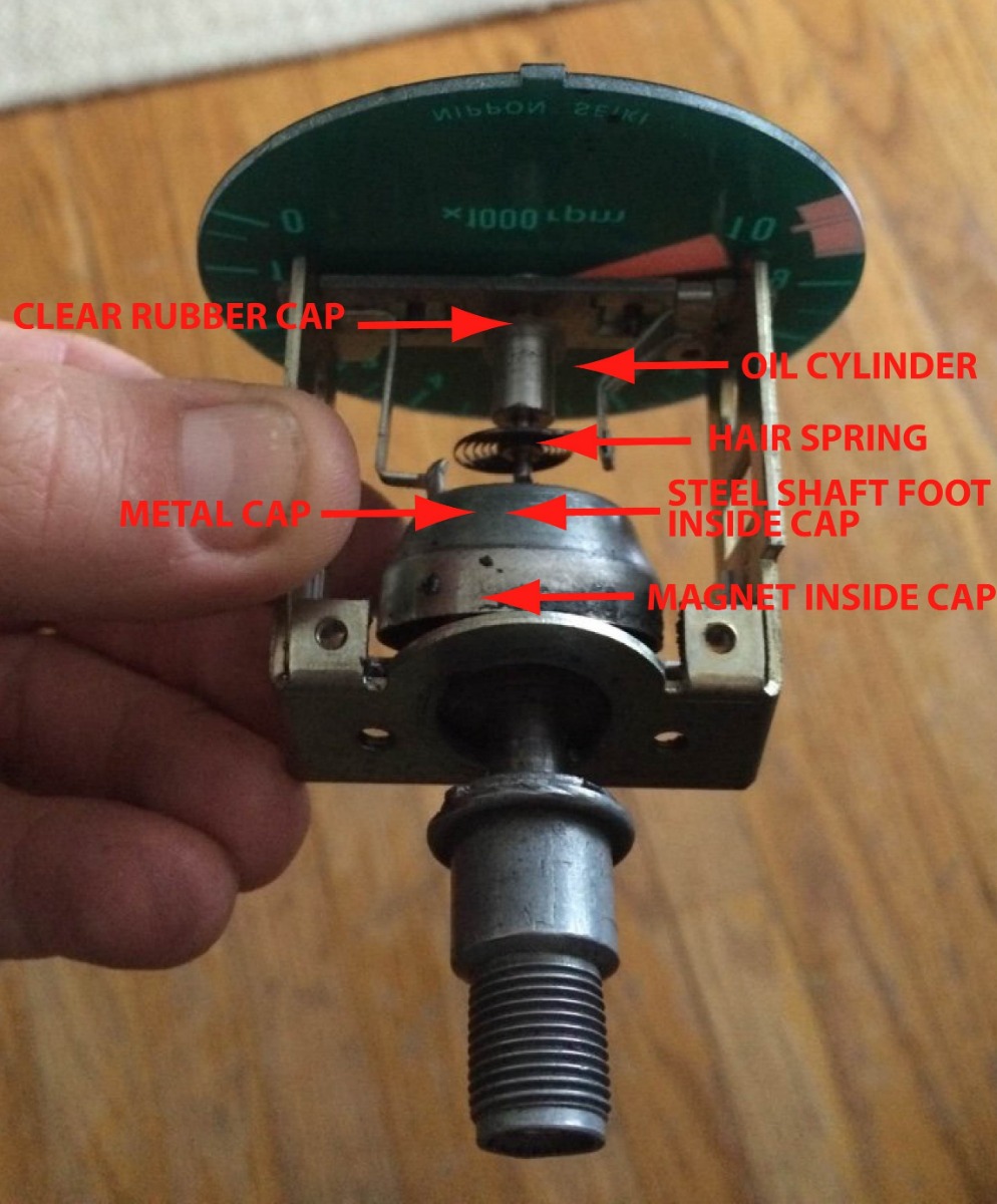

The oil reservoir has a a clear rubber cap. You can inject oil into it using a seringe. Use a light machine oil like 3 in 1.
If the damper has no oil in it the needle will fluctuate at little but the it will NOT be noisy like you described earlier.
Not a khi guage but they are pretty much all the same.
As I posted earlier, if it's noisy when on the bike but not with a drill then the cable very likely has a broken braid which is snagging as it rotates which will cause noise and needle flicker.

07 Dec 2022 17:53Wow, that's very similar to my bike. Thanks for posting!The oil reservoir has a a clear rubber cap. You can inject oil into it using a seringe. Use a light machine oil like 3 in 1.
Is the needle removable on that particular gauge?
Also, is play that allows the metal cap to move back and forth ~ 1 mm with respect to the gauge face normal?

Metal cap over the magnet drive shouldn't have any play.
The needle on this guage has metal tangs that fold under the top bush. If you bend down the tangs the needle will come off.
The head of the Bush the needle sits on is bigger than the hole in the clock face so the face can't be taken off without removing the bush. The bush is a tight push fit on the very fine central shaft. Unless you have to, don't try to remove the bush as it very very easy to snap the fine shaft and ruin the guage.
If you do want to remove the bush then a couple of teaspoons, one each side under the bush and gently lever both sides equally at the same time. AVOID levering so you are lifting one side more than the other or you WILL snap the shaft and wreck the guage.
