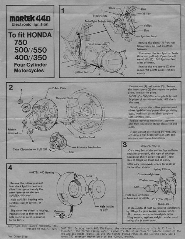

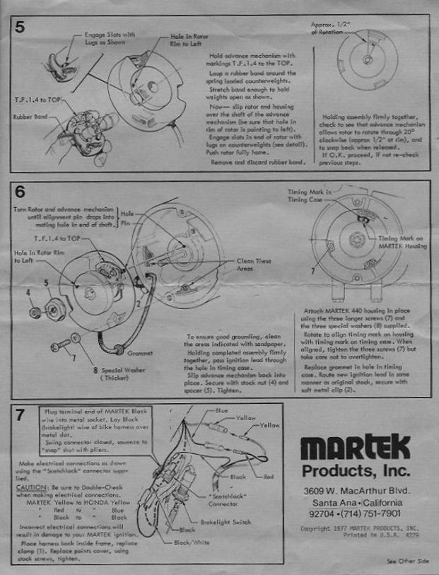

Not sure if this will help you are not but I do have some documents from Martek, which as I understand it was first intended for the Honda 750 but was sold to be used on the KZ650. I did a quick read and did not note any difference in coil from points to the Martek system. I do not know if that is true or not. But here you go.
