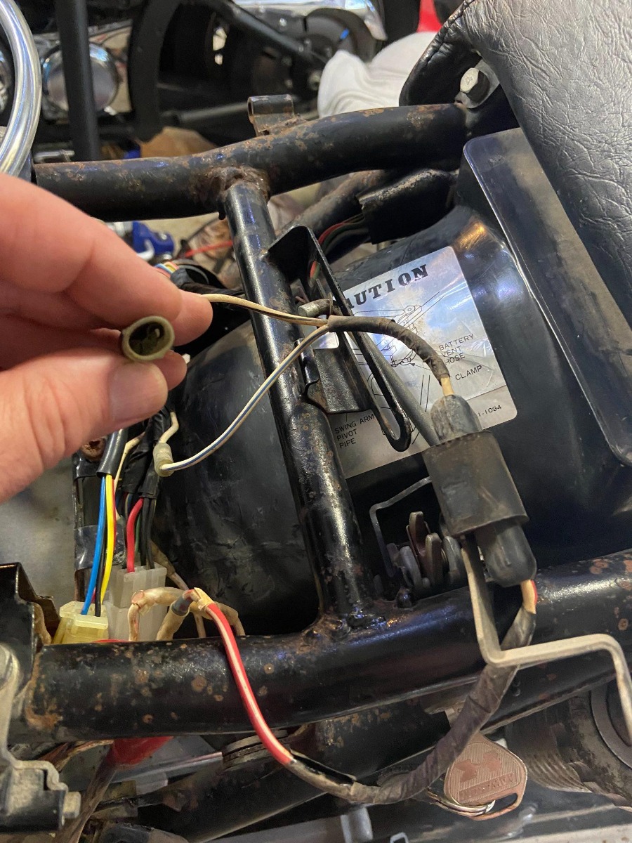

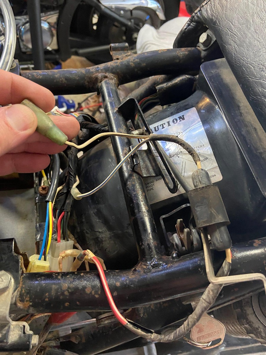

What does this plug in to?

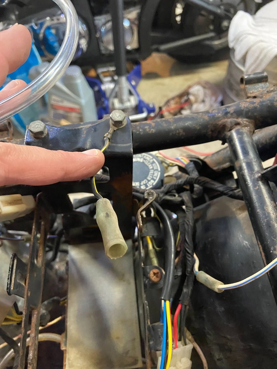

How bout this ground?

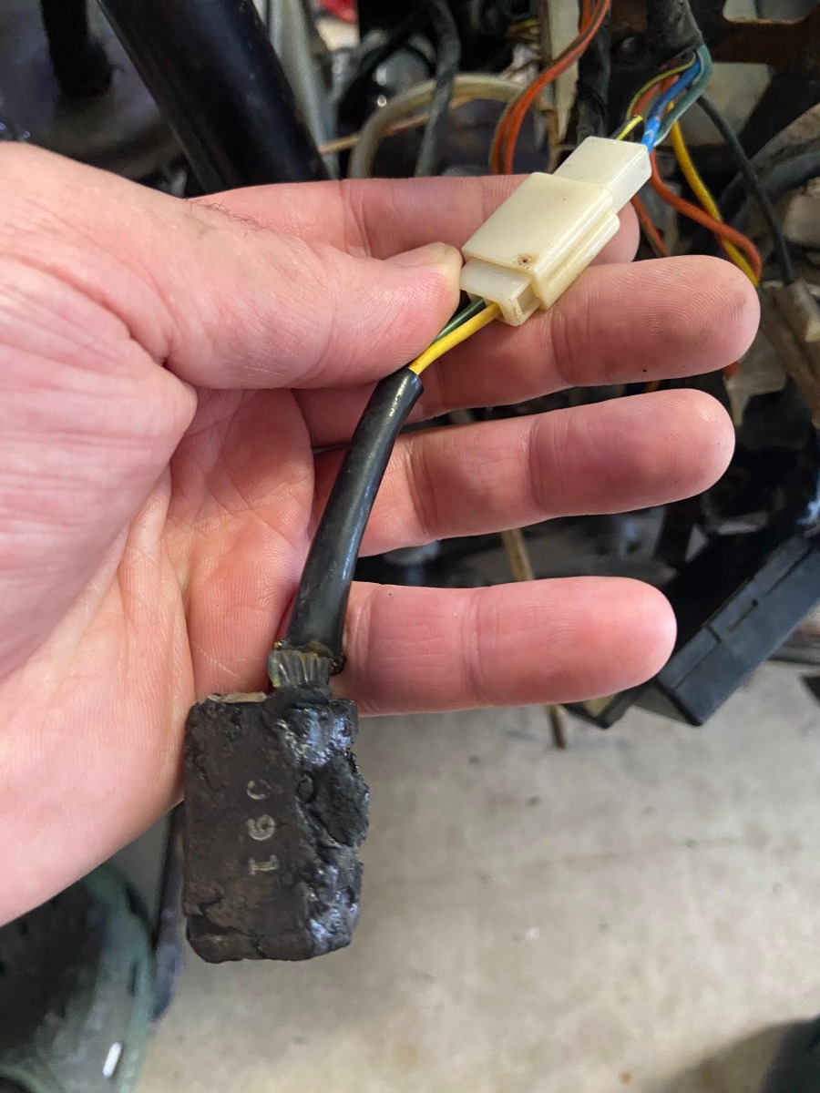

What is this thing? Is it supposed to look like that?

First two pics show the acc fuse box: white-black is an acc power terminal.
The white-blue acc wire should go to the headlight bucket where there's another acc power terminal.
Third pic is an acc ground & there should be another acc ground in the headlight bucket.
Last pic is either an outage indicator switch, fuel check switch or brake light failure switch: the wiring diagram is showing the latter w yellow, black & green-white wires. It's melted for some reason. possibly shorted out. ???
Brake light switch: on my 81 KZ650-CSR the brake/warning light at the tachometer comes on whenever the brake is applied. If the Rr brake light bulb burns out, the switch senses the failure & the warning light flashes. You can test the switch by removing the brake light bulb. see manual for specifics.

For others troubleshooting...weird box in the last picture is a Brake Light Failure Indicator Switch.
The other two are electrical accessory leads.
