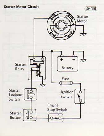

You could try jumping across the lugs on the starter relay and see if the starter turns. Also make sure the clutch lever switch is connected and working. I have attached a simple diag. of the starter circuit.

“Replaced the handle bars” I’d be looking at a loose wire to the starter button RH control or the black wires that are the starter lockout on the LH control.
