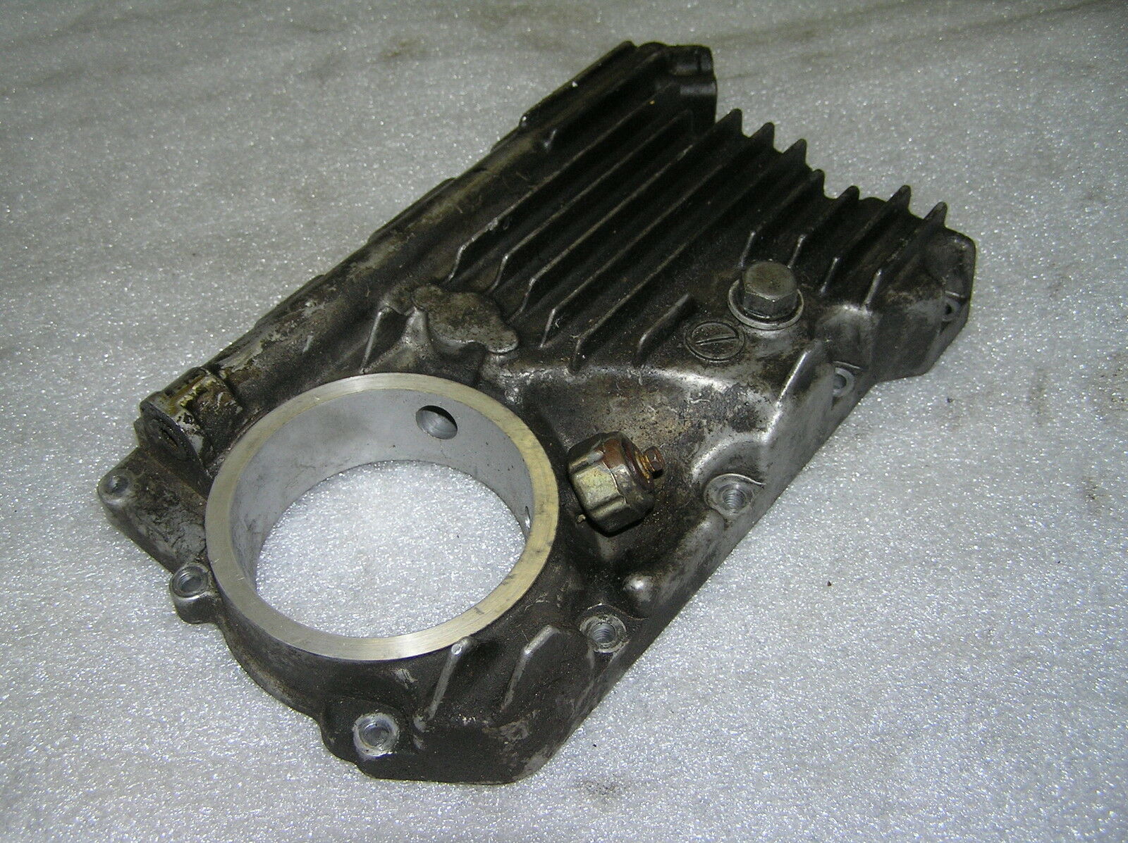

23 Sep 2022 03:24That looks very much like my sump, Can I ask which manual you are showing the pictures from? A picture of the front cover would be good too if you don't mind.

- Thanks: 2260
Re: Oil pressure light on European Z400J four cyclinder.
23 Sep 2022 04:16
The following user(s) said Thank You: zedordead

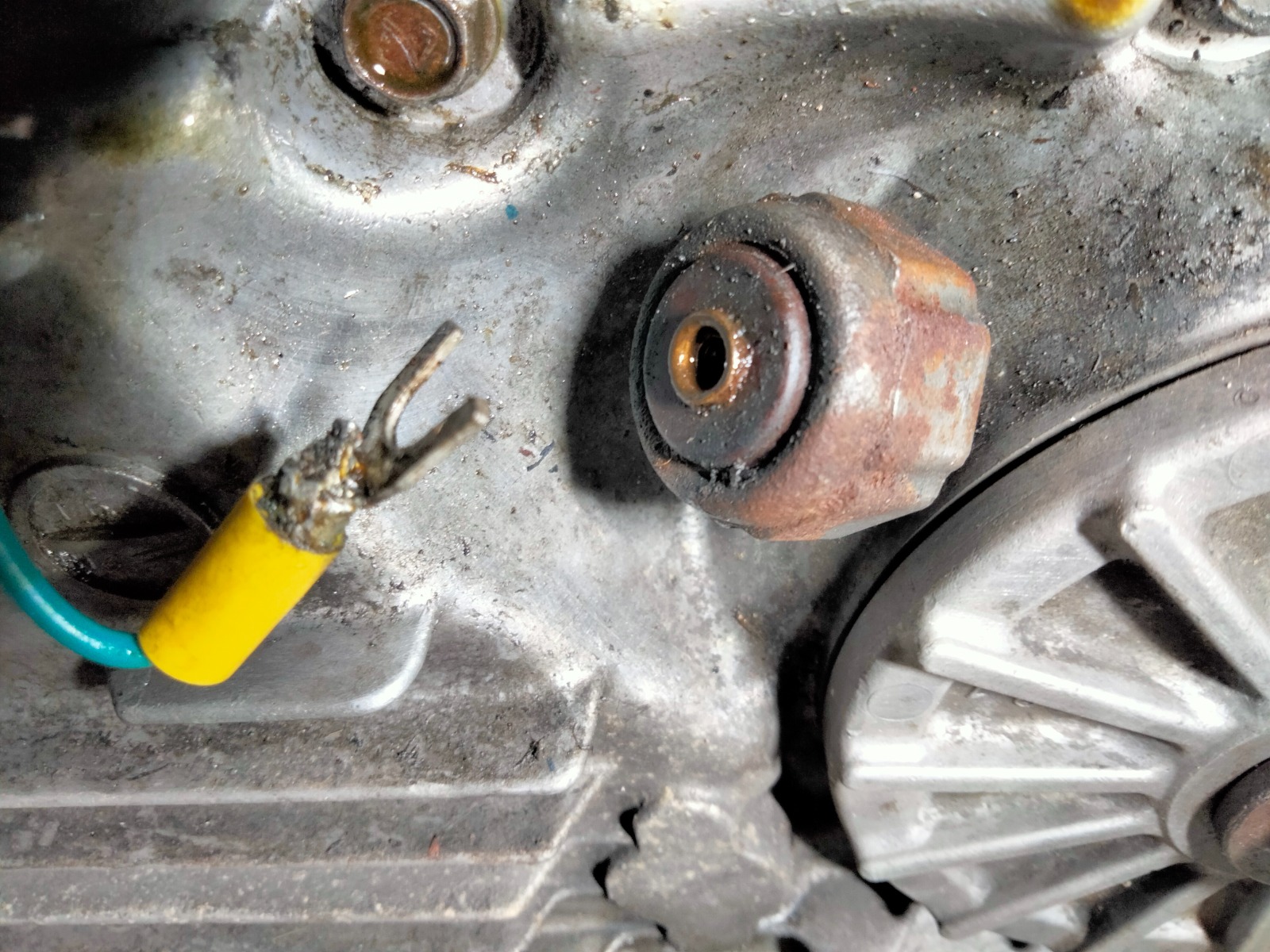

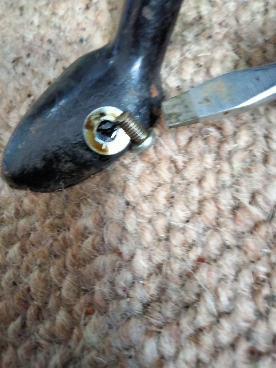

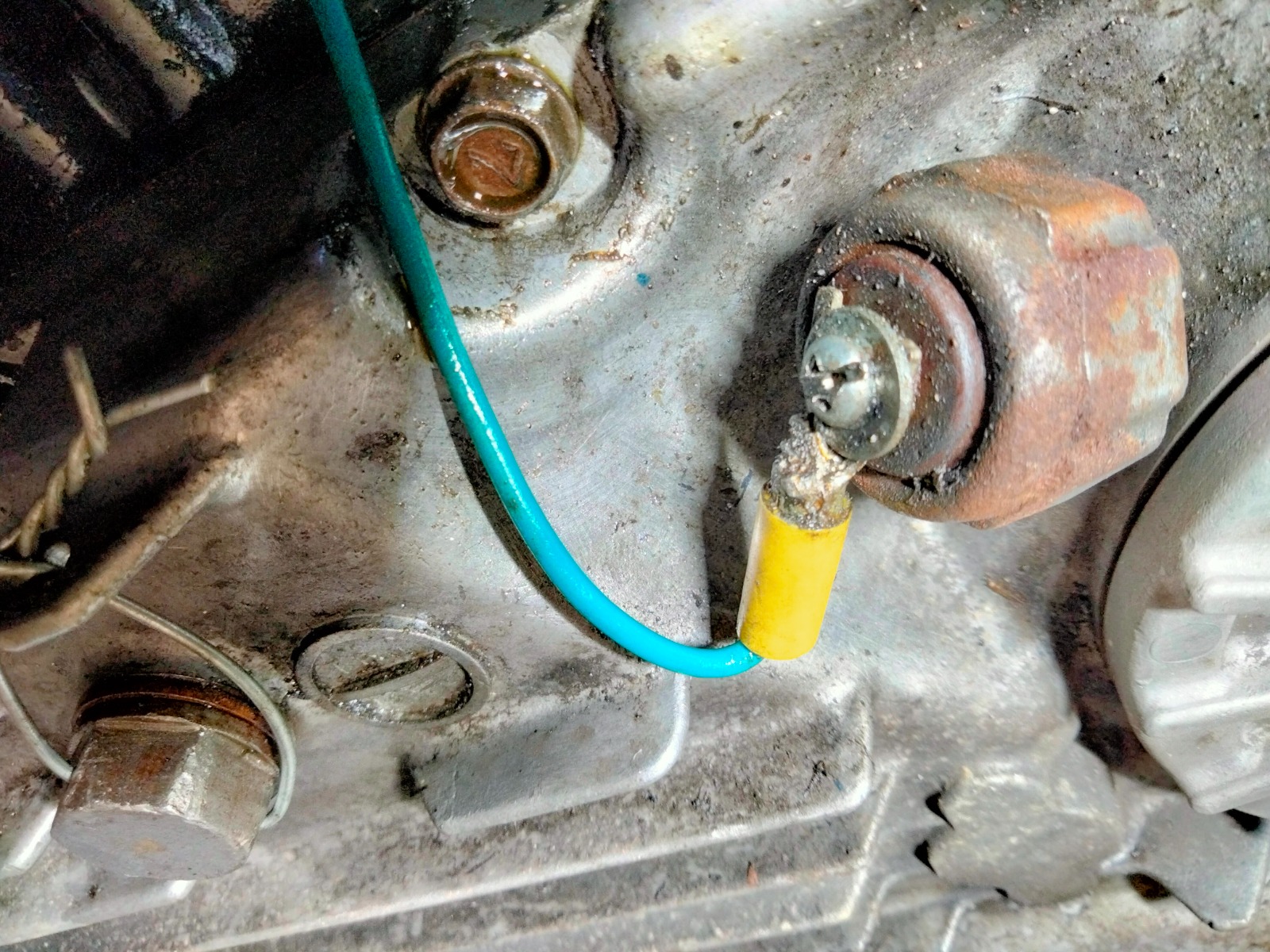

Thanks for all the great advice folks, this is what I've found (those of a nervous disposition should look away now)
This is what we have.
This is what we have when I removed the screw holding the wire to the switch
This is the length of the aforementioned screw
Thoughts please Gentlemen.
