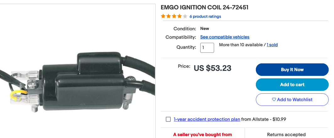

Your charging system sounds fine. 14.3 V at idle is no problem and suggests your stator is strong.
The coil issue is separate. What coils are you using? 5 ohm coils?

19 Sep 2022 07:47 - 19 Sep 2022 07:48
Hey! Nessism! Thanks for giving me a sense of relief about the stator.
The ignition coil is brand new, the emgo replacement seen below. Ive never been able to find a kawa brand replacement.
Ive only EVER had this problem when its above 80 degrees out. its so weird. I'll be glad when I get to the bottom of it.

19 Sep 2022 07:56
Those coils should be okay...I think.
One thing I do know, you should not allow your bike to idle for 10 minutes, unless you put a fan blowing on the engine.
