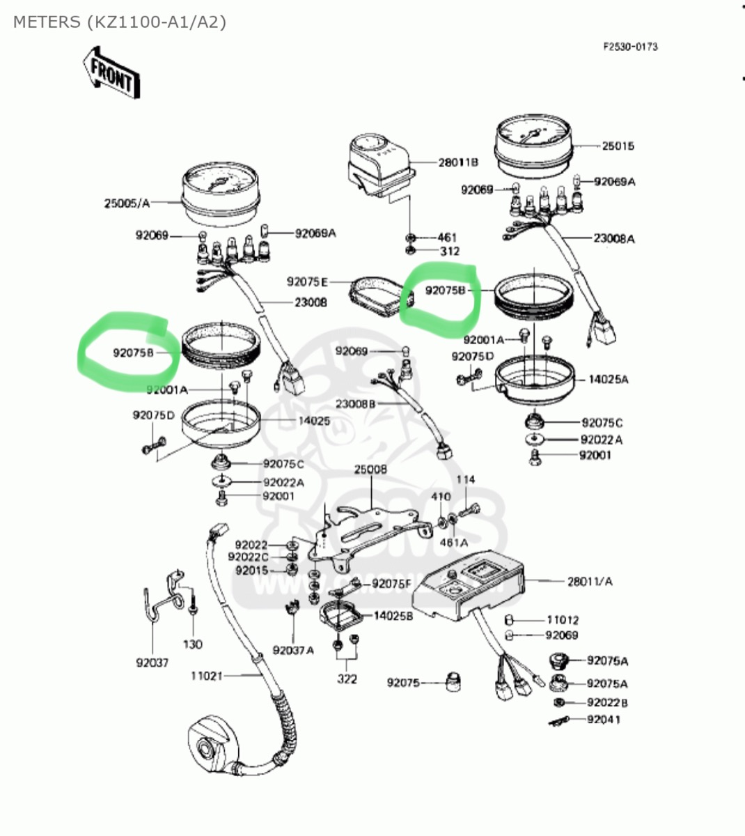

Does any inmate know of a source or substitute for replacing the rubber isolating gasket between the speedo/tach and the mounting cup?

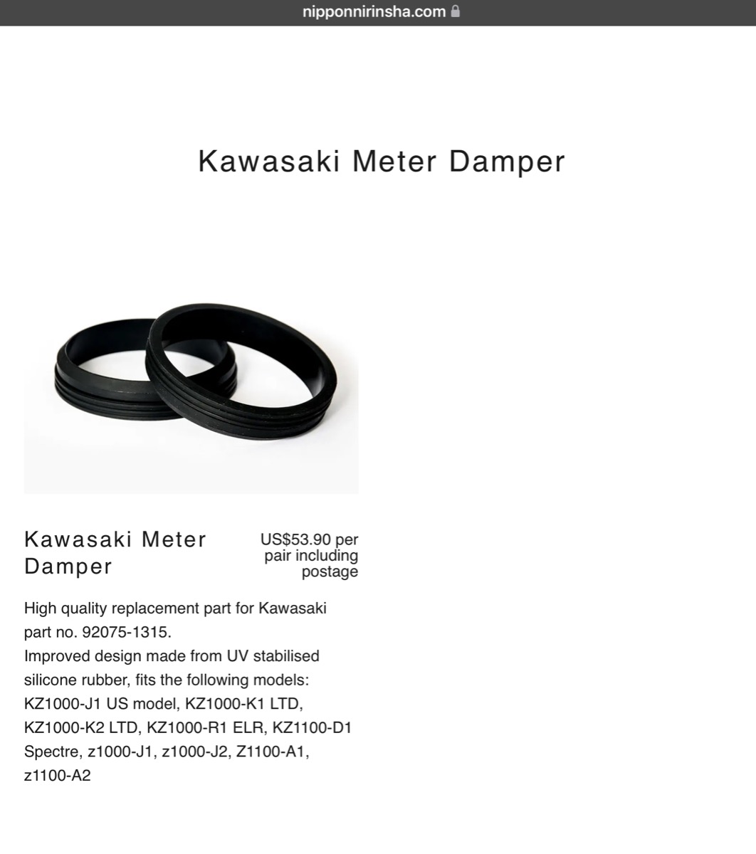

Great, Guys! Thanks. That new part number, 92075-1315, brings up good info also. Seems there might still be a guy in Australia that makes reproductions. A little pricey though at $53 w/shipping.

I could be wrong, but I think the guy in Australia doesn't make them anymore (Nippon Nirishi or something like that).
