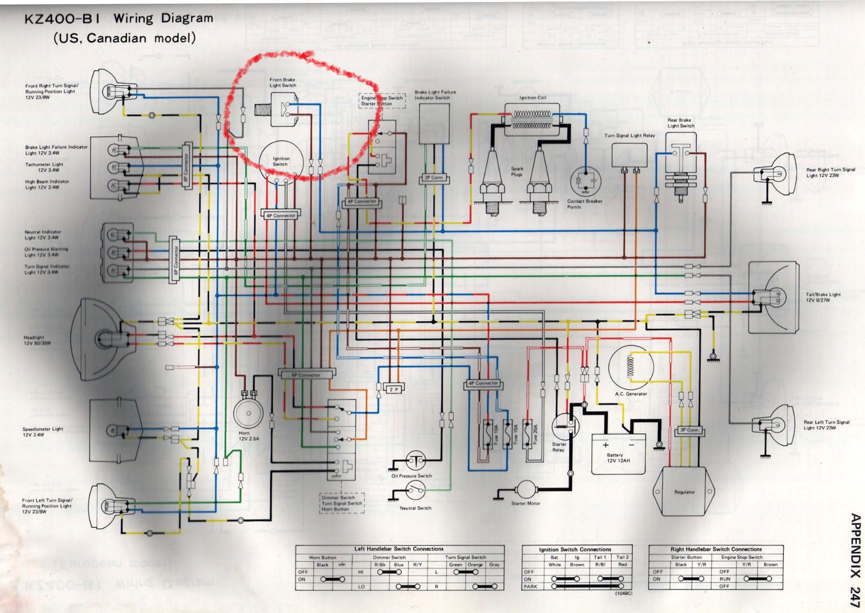

hello
I install a new plug on my vintage kawasaki a front brake ligth switch part 43065-001
It have 2 wires on this plug a brown and a blue my question it have a side to put the wires or you put any wire on any plug on the switch - help my

Re: front brake ligth switch on kawasaki kz400 1978
03 Aug 2022 21:13
It´s only a switch, so it doesn´t matter.
05 Aug 2022 08:01Yup. Just a lowley old switch! A controlled break in the wire!It´s only a switch, so it doesn´t matter.
