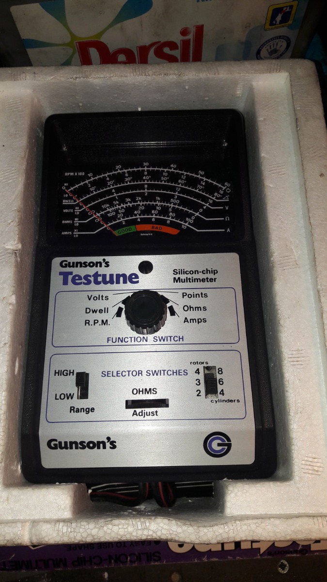

Possibly, but then it's not a dwell meter he's using but an electronic multi meter with a dwell function and a tacho function. similar to the pic I posted below which is not a dwell meter but a multimeter.
His thread title specifically said dwell meter.
If it has a tacho function and the bike has points/condensors chances are the meter doesn't have a built in damper and the needle will jump about all over the place as points ignition has very erratic pulse voltage to the coils. The very reason electronic ignition was developed originally.
Rather than doing it half hearted and guesstimating he'd be better off getting a colour tune and doing right. They aren't expensive.
Rigth tool for the job will always get the best results for half the effort.
