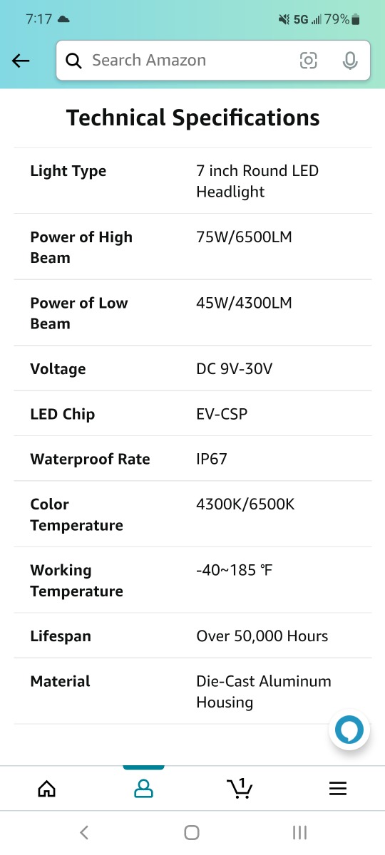

Just gonna post a pic of the specs of my led headlight for confirmation, been on there for a year without causing issue but I do know it's listed as higher wattage than the stock

The specs are deceptive, it shows an equivalent (75w) power but doesn't show current draw, however it is widely recognised LED draws significantly lower current.

Again, that's what I thought but without the specs for current draw and adding that I don't own an ammeter so I couldnt be sure. Appreciate the help.
