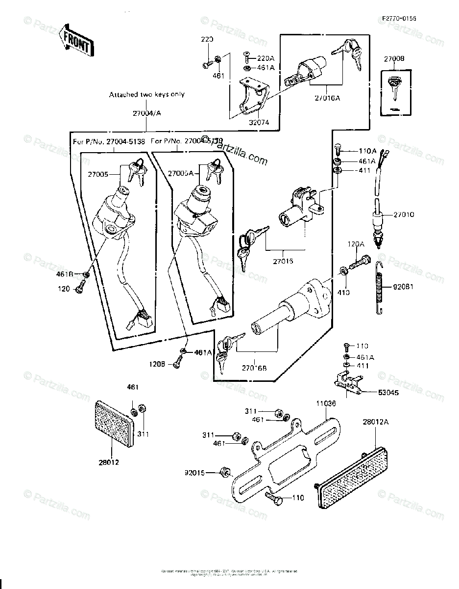

What 1982 KZ1100 model do you have?
The left one 27005 (Kaw part # 27005-5019) shown below looks like the switch my KZ1100-A2 has:

How does your igniton switch, connector and steering lock pin position looks like?

ok my steering lock comes out the bottom of switch.
EMGO 40-80610 shows it coming out the side of switch.
does a replacement switch exist with steering lock coming out the bottom?
