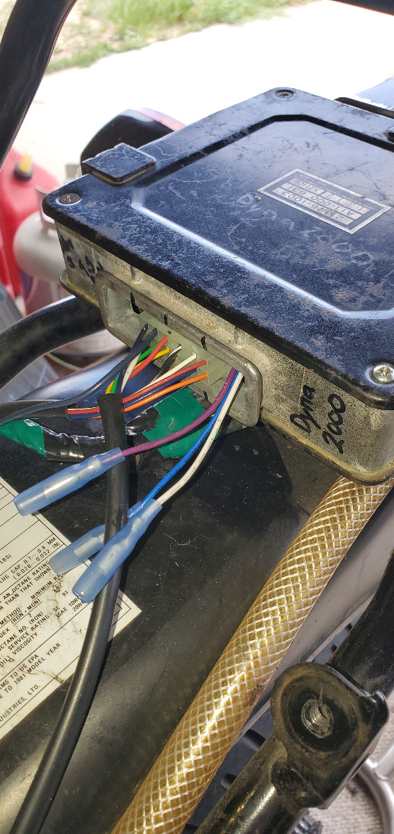

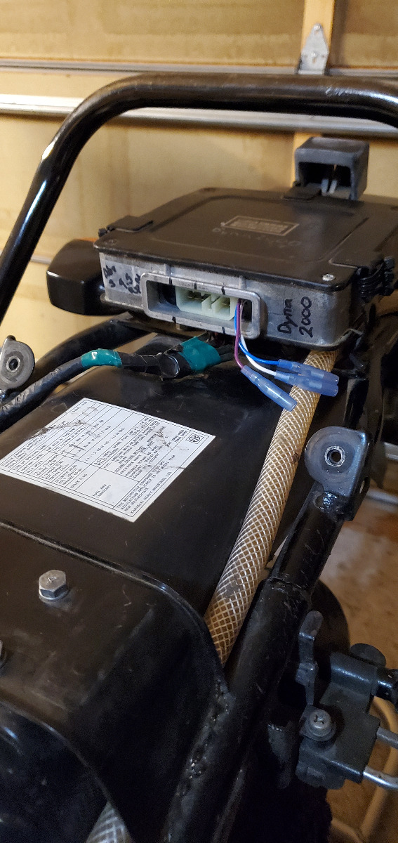

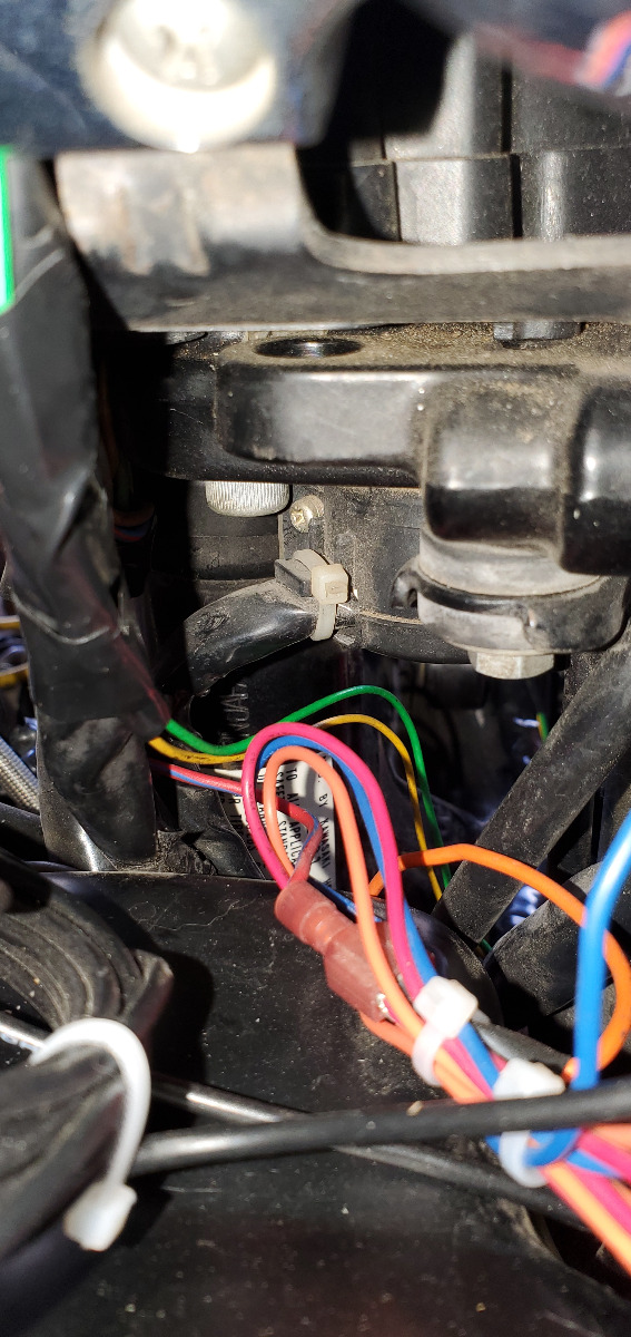

I finished the wiring and mounting of my Dyna2000 system. I found a cool and factory looking way to mount the ignition. I used a dead ECU FI box that I removed all the dead boards from. The Dyna2000 fit perfectly, I velcroed it in, and faced the connector out the interface hole. Sealed and mounted just like factory.

27 May 2022 15:33
That looks awesome man! The only thing I would be worried about is heat. I would be curious as to how it retains heat in that box. Other than that it looks awesome!

Good point, might drill some vent holes to some air flow.

29 May 2022 00:39The ECU box is made of alloy to act as a heat sink (as long as what's inside is physically mounted to it). Very clean job by the wayThat looks awesome man! The only thing I would be worried about is heat. I would be curious as to how it retains heat in that box. Other than that it looks awesome!

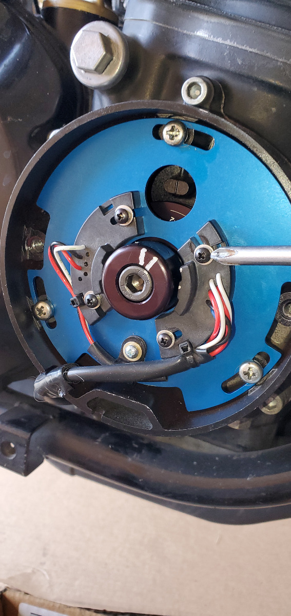

I left it as is, there is metal to metal contact and it basically became a heat sink...it never really got that warm. I finished the installation,
it came out pretty clean. One thing that caused some issues were the instructions for setting the static timing, I found that I had to adjust both the
pickup mount and the pickup sensors themselves. As you can see in the photo, the screw driver is pointing to the sensor, which has to be adjusted to match
the other one for a perfect 180 degrees delta. Mine were off quite a bit from the factory. The other confusion is exactly where the sensor actually triggers
on the rotor. There is a magnet in the rotor, which can be seen as a dimple or filled in hole. The trigger point is (for mine) right at the edge of hole (you can see the marks I made), and you have to know this to set the static timing for each sensor. I set mine to 37.5 degrees, which is in the middle of the recommended range of 35 to 40 degrees. There are two tack sensor wires, one two pulses per rotation and the other one pulse....on the GPZ its is the single pulse. I also
set the curve to #4 which is the 2 valve unmodified setting. Other thing I found out is that DyanTech recommends 2.2 ohm coils for the best spark.
It fired right up, no problems, haven't ridden it yet as the weather has been crappy this week. The weekend looks promising, if ride I'll give a report on performance.
