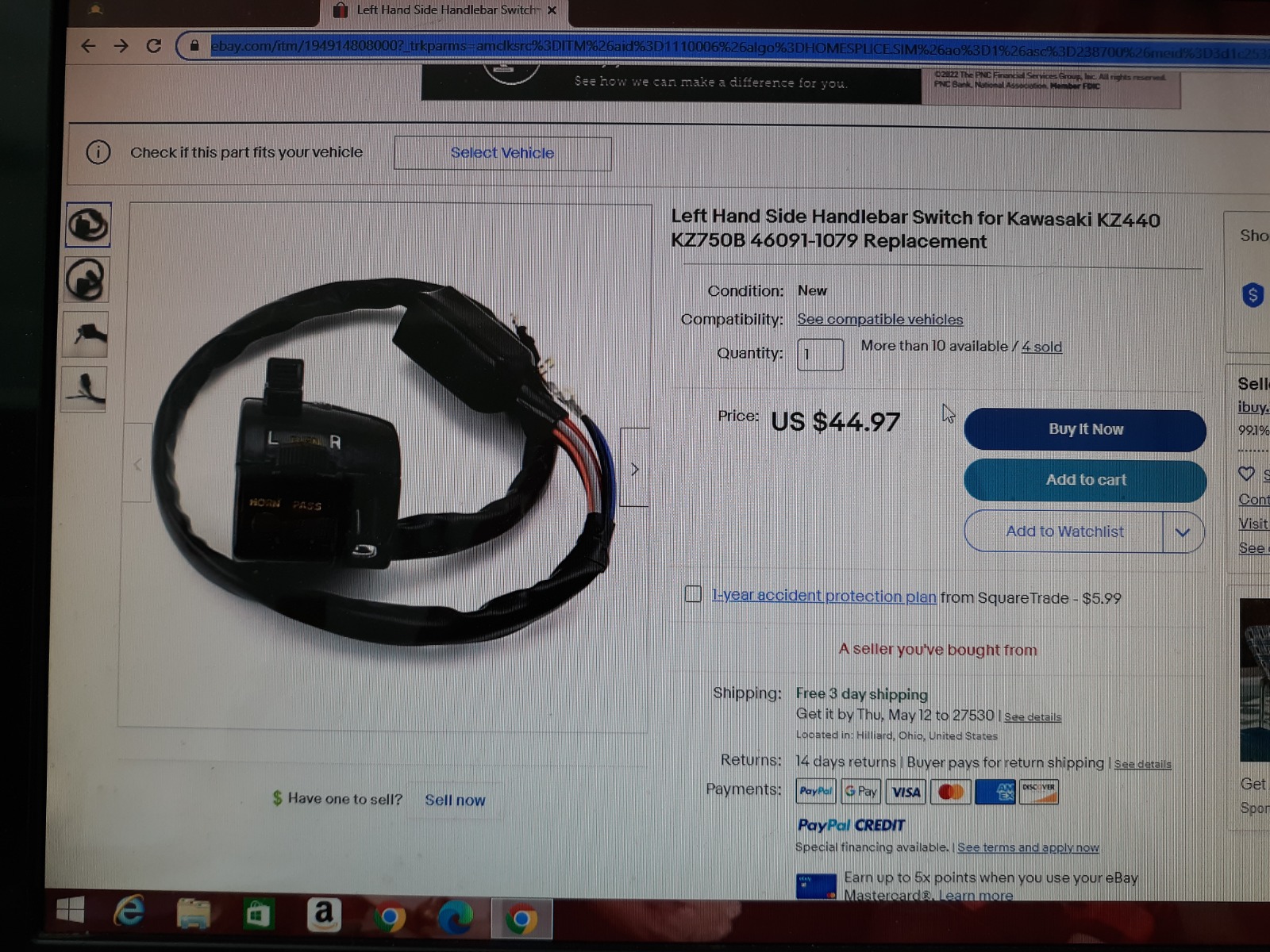

No eBay APP ID and/or Cert ID defined in Kunena configurationAnybody have experience with these new switch assemblies? Plug & play?

Maybe someone else will chime in. If the controls & wire colors are the same, it's probably at least pretty close to plug-n-play. but until you get a definitive answer, I wouldn't assume anything. wishy washy answer. ha ha.

Yup; I've bought several things from IbuyIsell (as seen on your pic of the Ebay page) and that switch is one of them. It does indeed plug right in, even the spade connector and bullet - I just put one on my '79 KZ400H yesterday - and while I'll have to check the wiring 'colors', it's a very nice switch and almost identical to the OEM one. Well worth it.

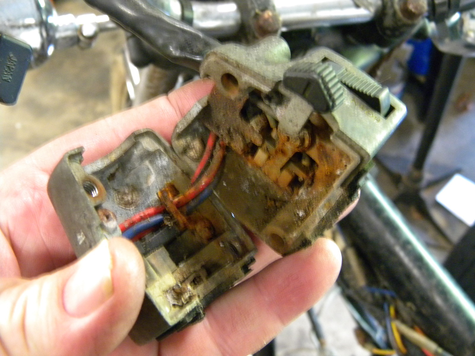

My left switch almost looked like a geode inside:
I've actually rebuilt switches that looked like this when they were hard to find, like in my '68 Puch 250, but with more modern bikes like this KZ400 H I'll just replace them. They look better too!
