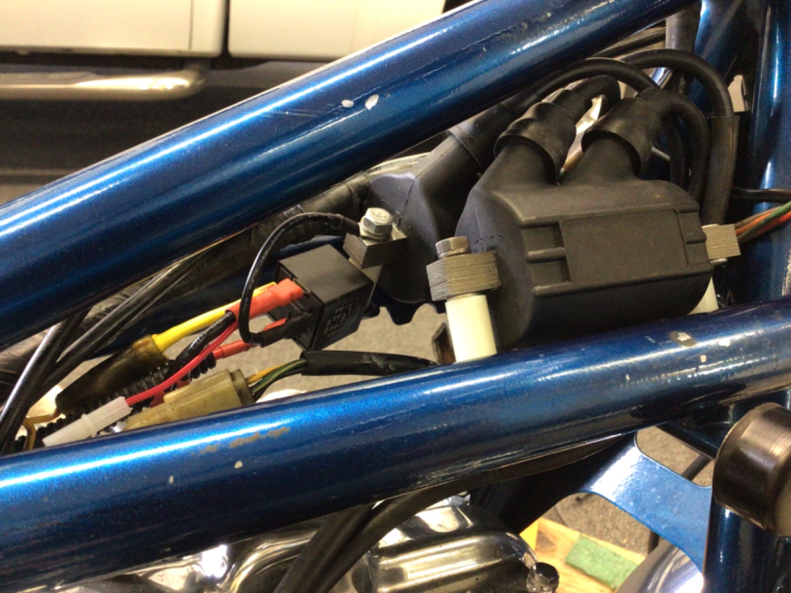

Re: Ignition by-pass relay W
06 Jan 2024 14:42 - 06 Jan 2024 14:43
Bypass switch installed. I thought I’d post a pic so others could see one installed. Painstaking but I’m a firm believer now that this mod is a good thing to do.
