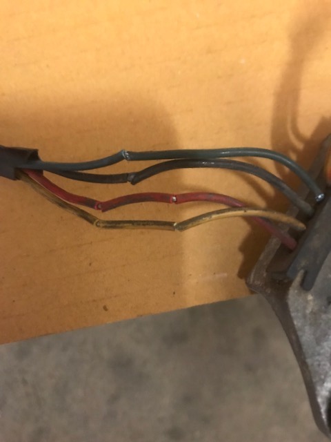

Below is the igniter for my 82 Ltd and the wiring has age hardened ( you can see the cracks from bending the wire) each one of those cracks will allow moisture to get into the cable and start corroding it) eventually if left there would be green powder deposits around the crack and the circuit would stop working.

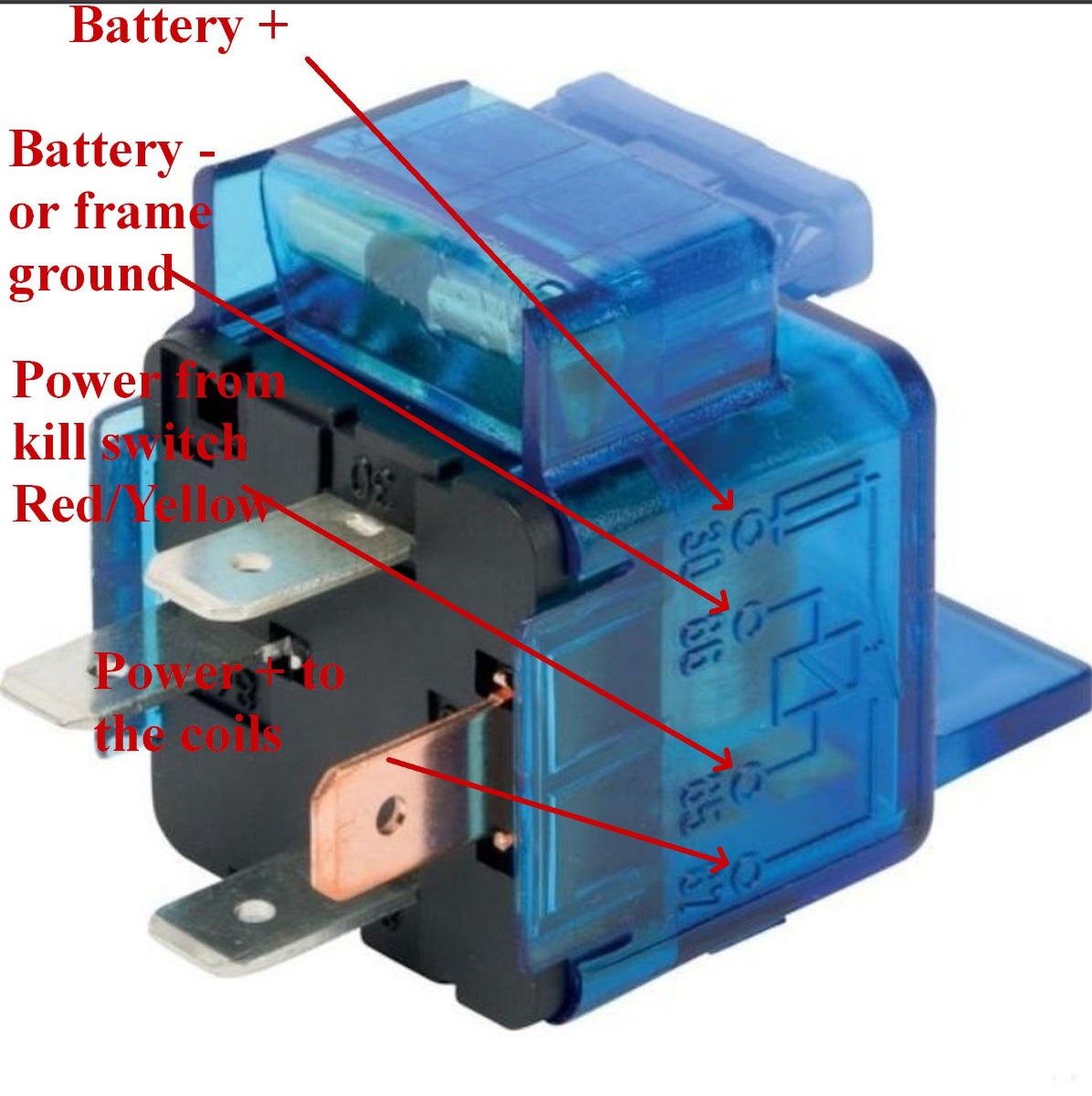

Below is the simplest diagram I've seen for adding a relay. (I've had it in my "to do" folder for a while now.)
I believe it's from forum user Wired George?
Dyna S coils or standard OE, same applies.
