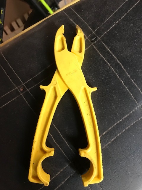

Re: Not firing and got shocked by the boot
23 Mar 2022 10:09 - 23 Mar 2022 10:11
Last edit: 23 Mar 2022 10:11 by Wookie58.
