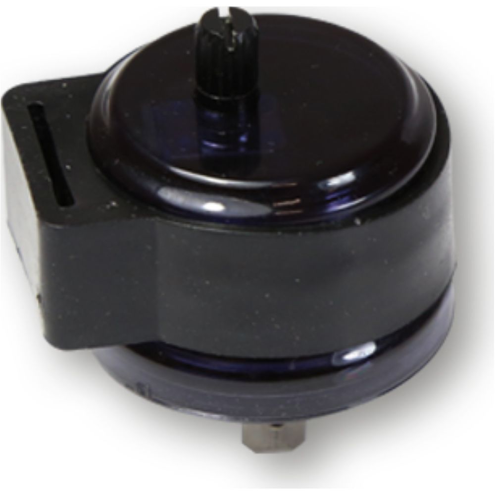

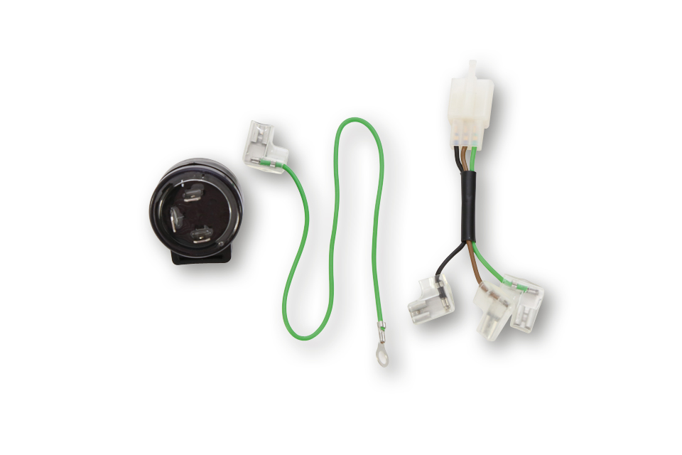

Search ebay or Amazon for SHIN YO 3-Pin relay. It´s load/current independent for bulb or LED use and you can adjust the blinking rate if needed.
I use the same relay with no problems. The blinking rate is adjustable between 30-90 pulse per minute. The green wire have to connect to ground (frame) or battery negative.

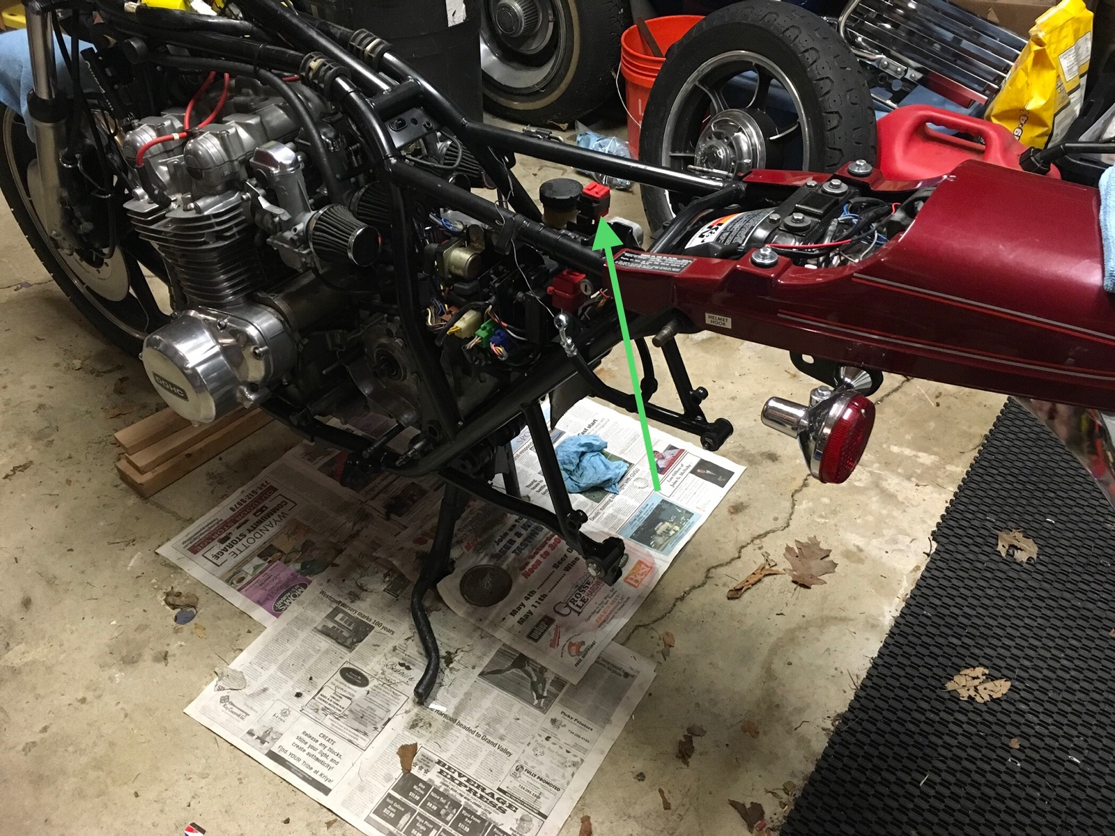

This is what I used when I swapped in all LED’s. It even fit in the rubber band and mounted in the OEM location.
www.superbrightleds.com/moreinfo/flasher...nic-flasher/779/833/
See green arrow

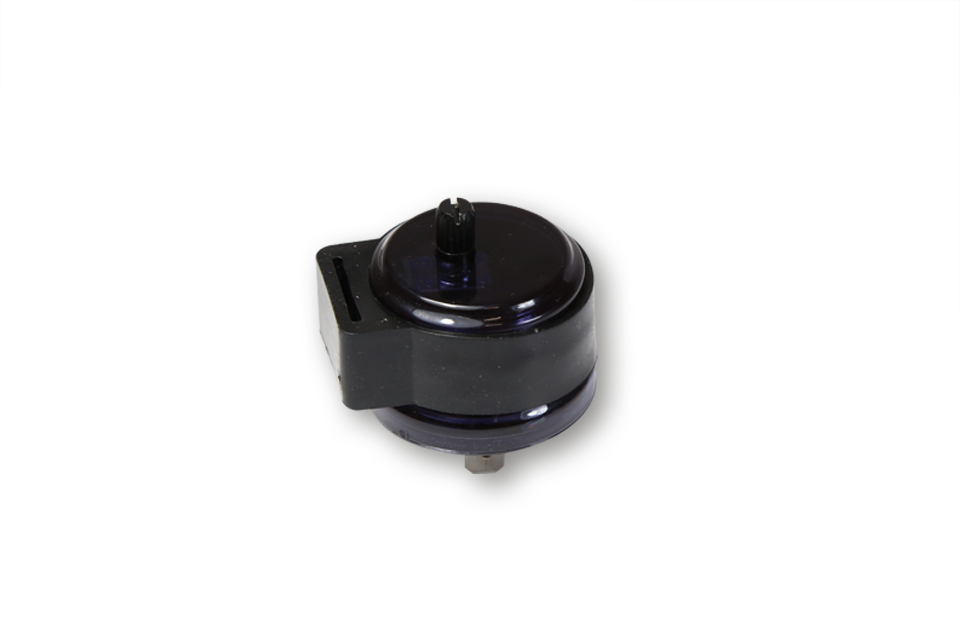

22 Mar 2022 23:12 - 22 Mar 2022 23:1465 - 95 Dollar for one relay is a way to expencive!!! I pay only 23 Euro or 25 Dollar here in Germany.Just looked for the SHIN YO 3-Pin relay; it would cost about $65 for seller one and $95 from seller 2!! I was expecting a few bucks...
Any idea for a less expensive option to slow down a bit the hazard rate?
ebay.de/itm/SHIN-YO-3-Pin-Universal-Blinkrelais-Blinkerrelais-12V-/303834150001
www.shin-yo.de/en/product/208-070-3-pin-...her-relay-12v-36470/
www.biketeile-service.de/de/motorradteil...lblinkrelais12v.html
