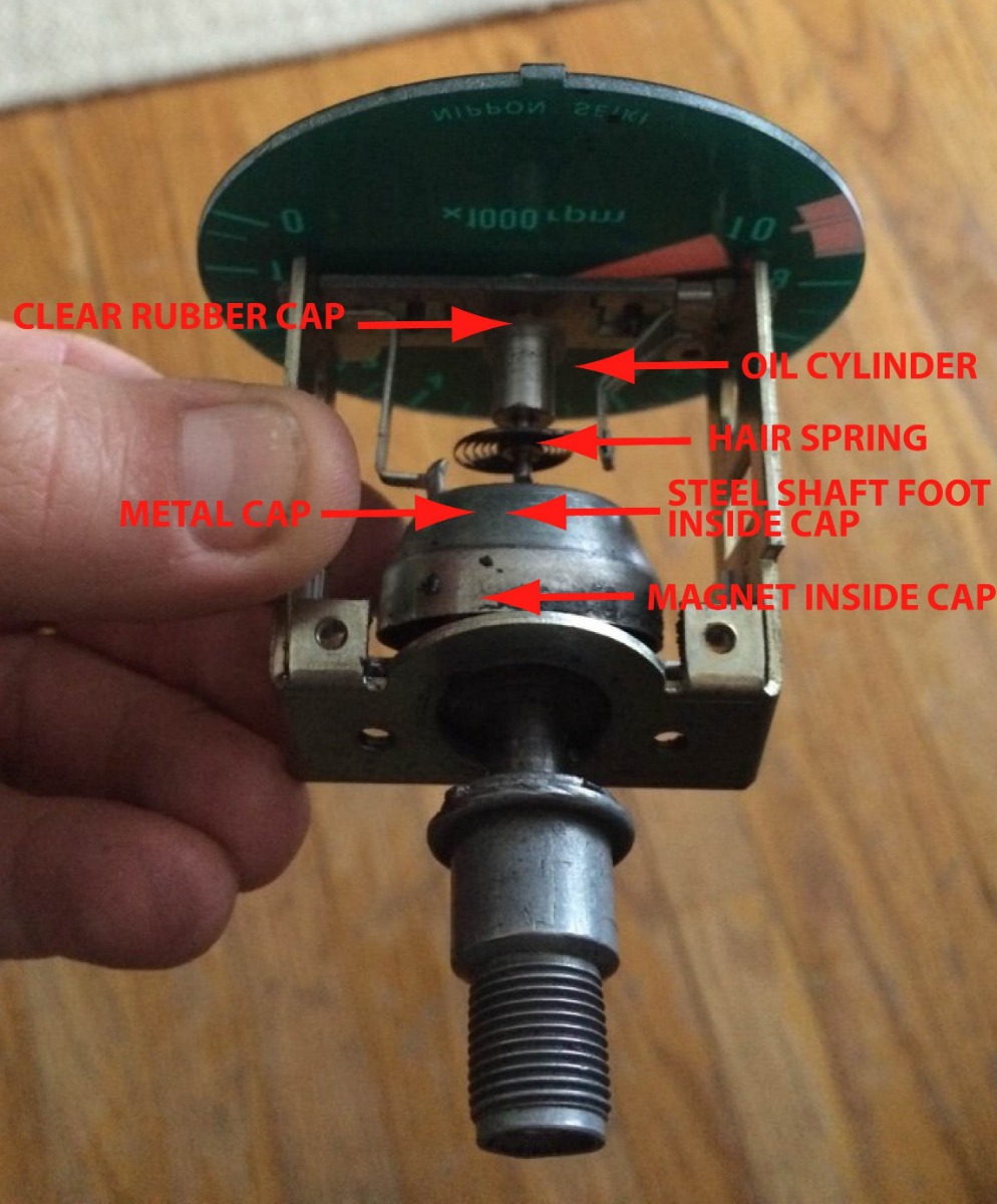

Speed's do not have internal gearing. They are driven by magnetic field.
It's more likely the face is printed slightly different with slightly larger gaps between the digits.
19 to 18 inch wheel circumference is a 5% difference.

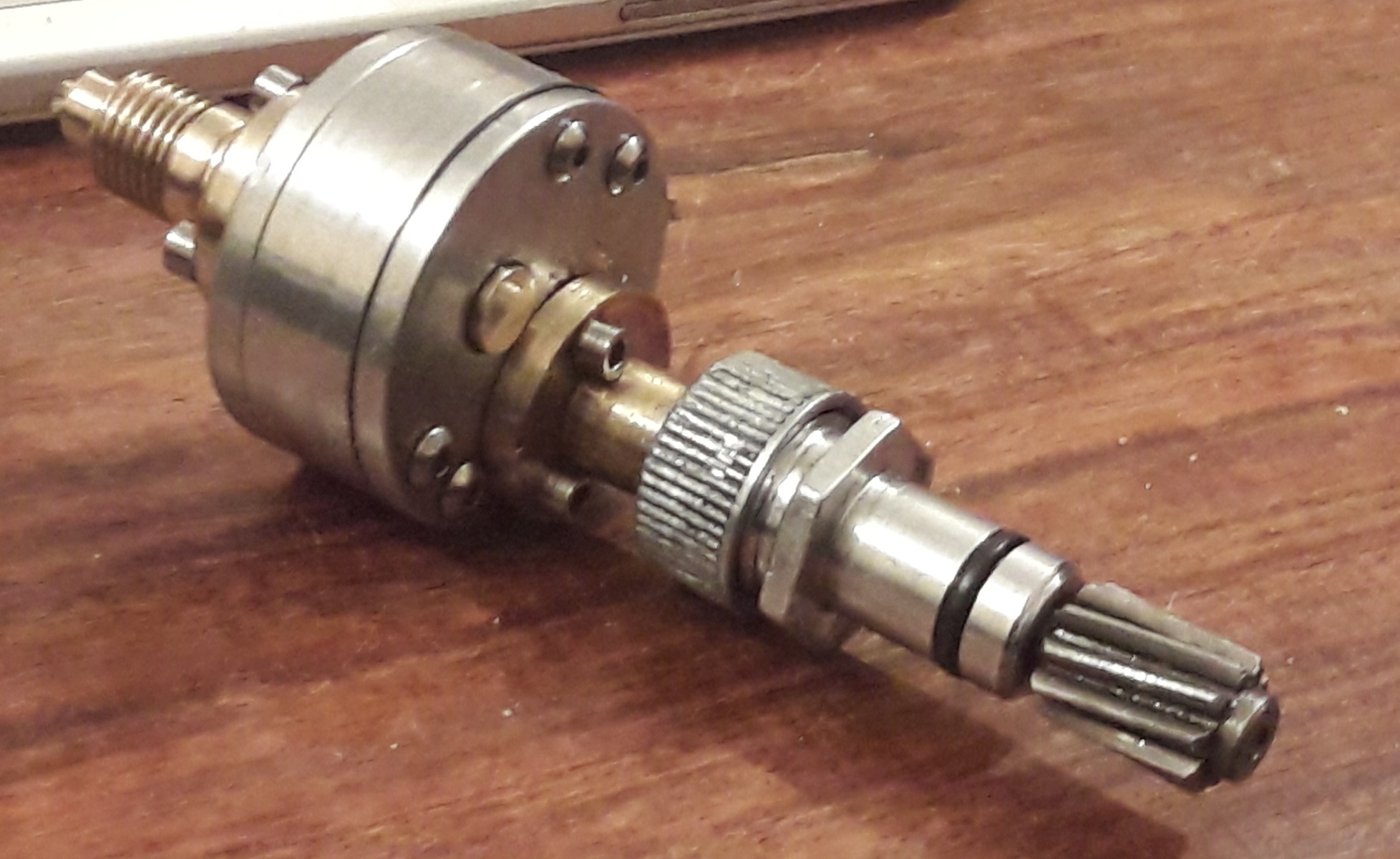

Not sure about speedo's but kawasaki seem to be the odd one out when it comes to drive ratios on rev counters. Kawa use 5:1 whereas everyone else uses 7:1.
Found this by chance when I wanted a tiny 2 inch rev counter for a specific build. Fitted it and at 1k tickover the guage read 1400.
As it was the only guage I could find that fitted the design I was after so I had to make an inline reduction gearbox.
