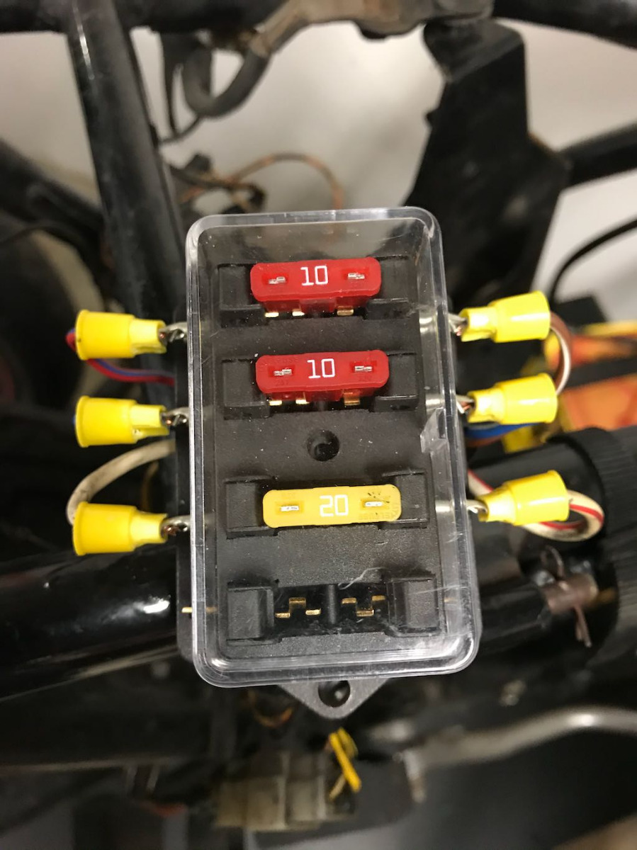

Here is how I did it. 4-in 4-out blade fuse box from ebay. Costs around 10$ ±. Fits in the original holder/clamp with a few small modifications. As far as weatherproofing go I think it's okay compared to the original one. If it starts to corrode I'll switch it out later. The original glass fuses are close to impossible to get here, so it will do for now.
Kawasaki KZ650 1979
Last edit: 17 Mar 2022 03:22 by Oysteinaar.
