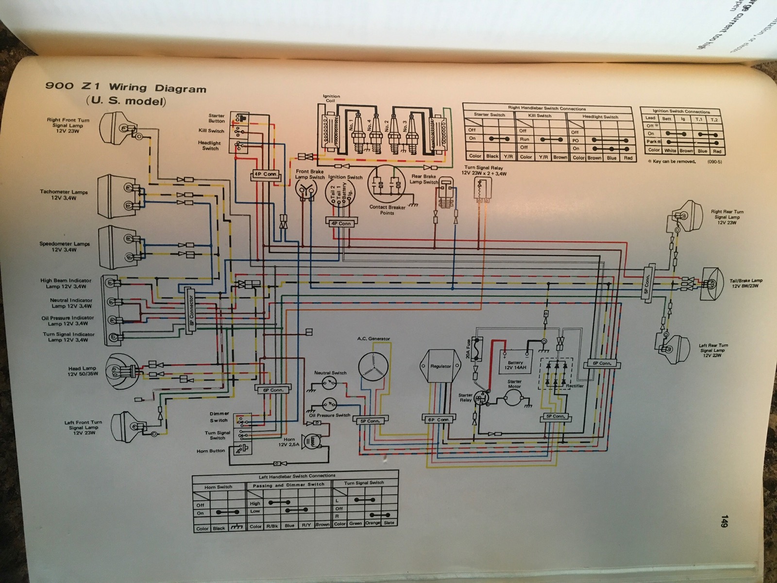

Hi TerryThis definately looks like a earth problem (you are loosing 11v, if this was a positive short you would blow a fuse of have a fire to put out) when looking for a fault that effects multiple consumers you need to look for the common denominator (in this case the ground) looking at the wiring diagram all of these systems come back to a single earth point I am sure the guys on here that are intimate with the Z1 will be able to tell you exactly where this is - Don't get hung up un the fact that you have a positive reading on the earth line, this simply means there is another resistance in the earth circuit for the voltage to overcome before it diminishes to approx 0v when it returns to the battery negative terminal (in this case a significant one if it is holding 11v in reserve to overcome it !)

21 Feb 2022 09:47typically there are two grounding points. The negative battery cable grounds the the upper engine case at the rear upper engine mount on the right hand side of the engine. The other is a black wire off the stater harness, off the relay bracket blue connector, that solid black wire is typically grounded to the chassis at the seat lock attachment bolt.
