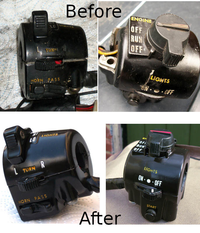

I have restored a few sets. I picked up this tip from Kidkawie. The paint colors match OEM damn close. The trick is to use wedge shaped makeup sponges and dab the color into the recessed letters. The art comes in the ability to wipe off the excess without taking the color out of the letter. If that happens let the color dry and reapply to the void ares. I use VHT roll bar and chassis and then 2K clear over with a matte clear.

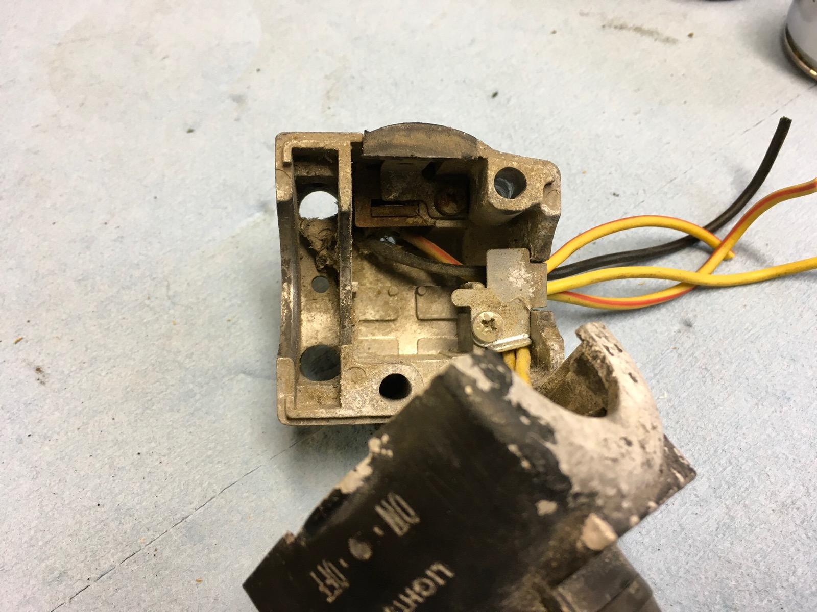

These still need some color touch up so they have not been clear coated yet.I have noticed the recessed letters are far from perfect in shape and definition so don’t obsess over trying to get perfect letter definition. Go For It. Take pictures of the wiring so you can get it back correctly. The small screws and clamp brackets can be soaked in metal rescue. If they are corroded short soaked in CLR works. Watch the soak times as you can ruin the hardware if soaked in the CLR to long.

Those look really nice! I've done a few with mixed success. I've found that they need to be completely stripped and blasted before painting. I use semi gloss, which is a bit brighter than original. I have paint sticks for the insets. Then I laquer them.

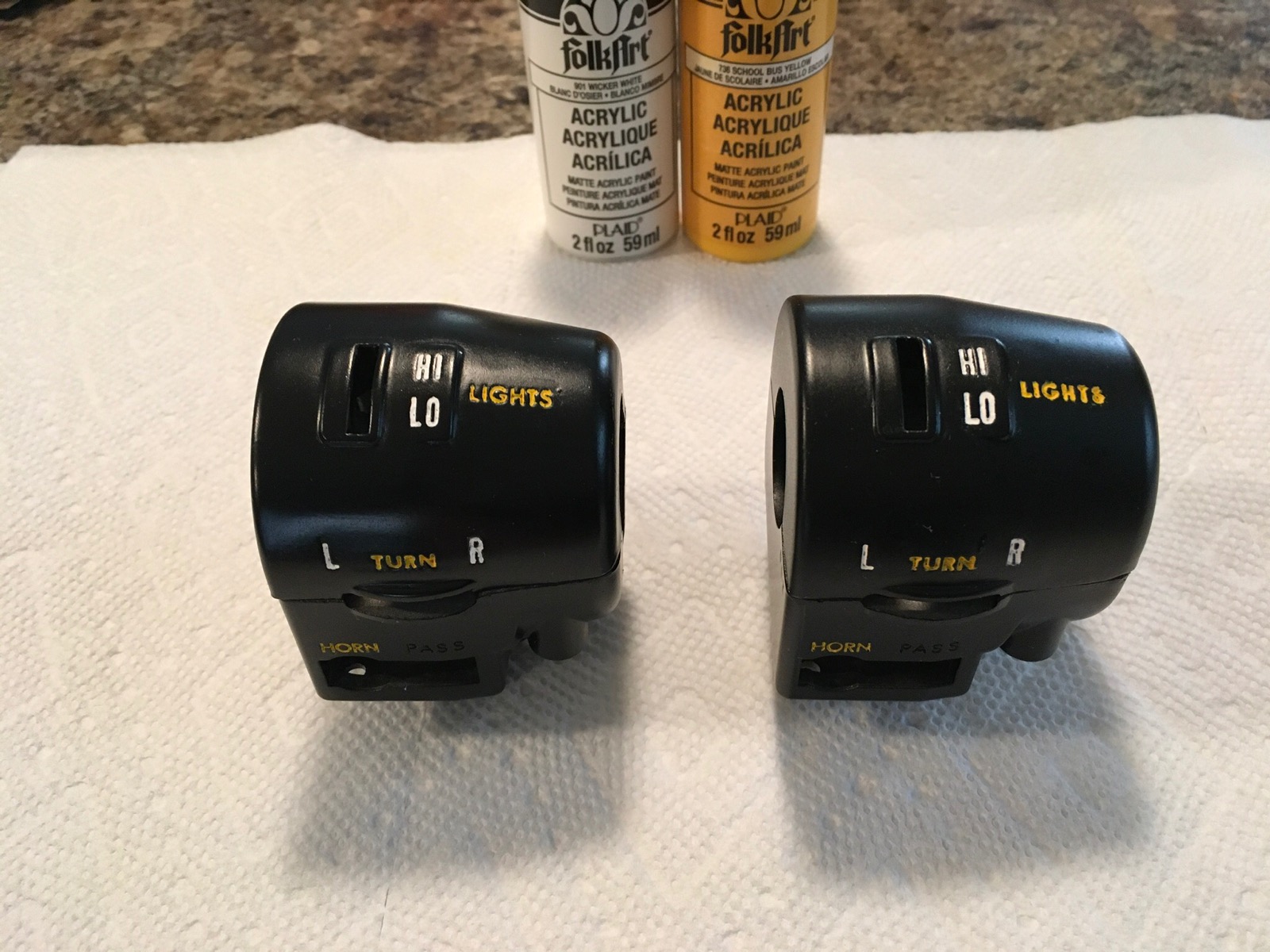

Did mine on the Z500 Paint is Techcote satin black. the lettering is acrylic Gamboge for the yellow and Titanium for the white. Followed by 2 coats of satin lacquer. the lettering was hand painted by my better half, many thanks Julie

Linuxrob. I never noticed an OEM different yellow for left to right. Now you got me thinking.

It must be the camera i used, flash, no flash? They are painted the same colour.
