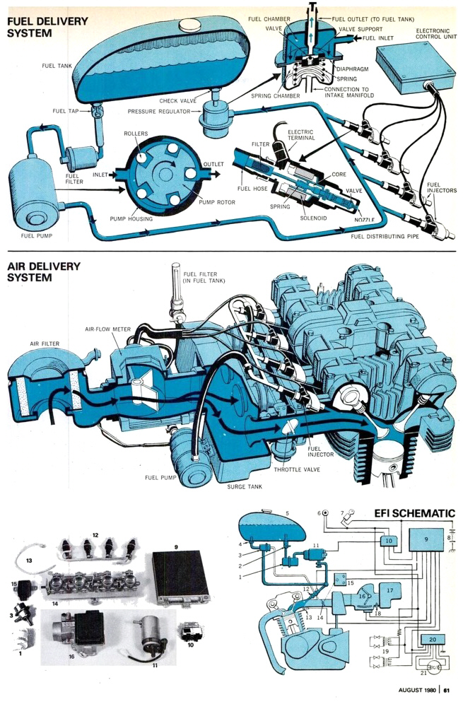

The ZX1100A1 (GPZ1100UT) don´t have any mass flow sensor!!!
AFAIK only the Z1000 H, Z1000 G (Classic) and Gpz1100 B1 use the mass flow sensor and analog EFI system.
Later models B2 and GPZ1100UT (ZX1100A1) use the DFI (digital) fuel injection (Alpha-N) system, with no mass flow sensor.
