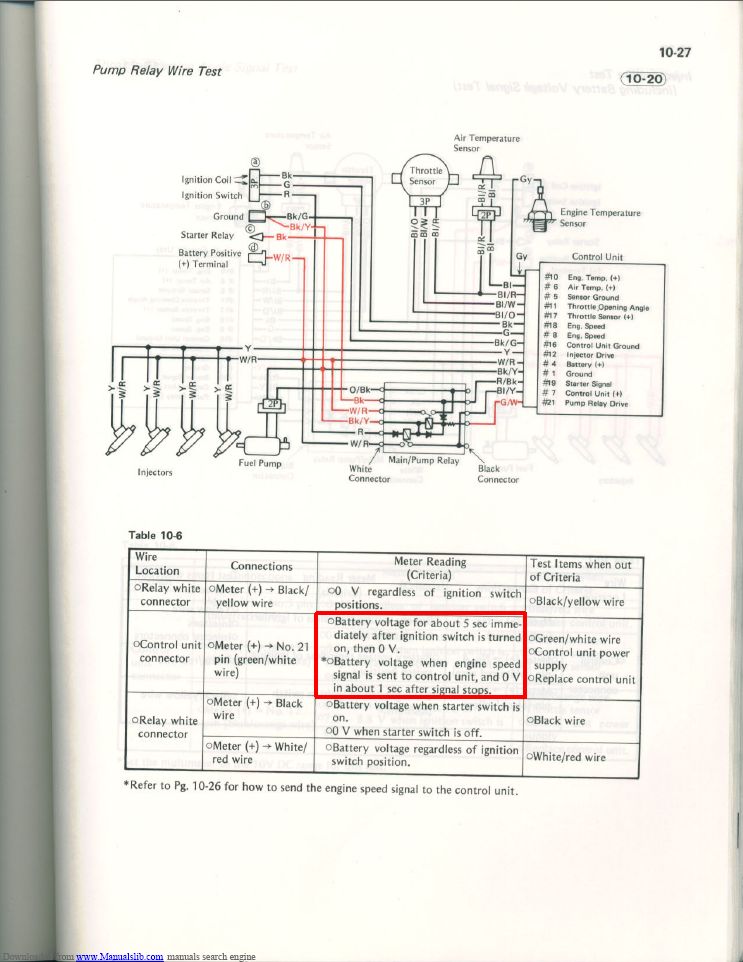

Thanks Scirocco, tried the test you suggested and the green/white wire is showing only 250Mv when ignition is switched on rather than battery voltage for 5 secs.
I've plugged in a spare control box and got the same result, so I'm hoping the control box is OK.
Could be a problem around the relay or connectors.
Scubaanders, I'll look to inspecting the relay as you did. I've also just ordered the VW Bosch relay as a back up in case the original one is toast.

Ok, think i’ve worked it out.
tested the relay as per the factory tests.
failed on testing conductivity between green/white wire in black connector to black/yellow in white connector - showing 0.82 instead of 0 ohms. Black/yellow wire is part of the ground circuit for the fuel pump.
i opened the relay and theres a diode in the middle of the connection which i guess has failed.
hopefully the pattern relay i’ve ordered will sort it out.

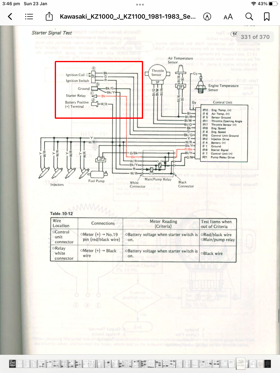

So it doesn’t seem to be the relay. Finally received a replacement main pump relay - and nothing. Still won’t prime the pump.
it cranks the engine fine.
i’ve run through the manual tests and its failing on the ‘starter signal test’
1. red/black wire at computer connector is not showing battery voltage.
2. black wire at main relay not showing battery voltage either.
both wires not showing resistance so seem ok.
green/white wire test also not showing battery voltage.
Connectors are all tight and clean.just doesn’t seem to be getting power.

Did you check your power connectors and wiring to the ECU
Ignition coils Bk and G, trigger signal from CDI unit (rpm) to the ECU = pulsing +12 Volt.
Triggers ECU, the pump relay drive and injector timing (engine running)
Switched power R +12 Volt from the ingition switch to wake up the ECU and pump relay drive (Priming only)
Ground Bk/G and Bk/Y to the pump relay and ECU
Switched power Bk +12 Volt from the starter relay to trigger the ECU, injectors and pump relay drive (engine e-start)
Permanent power W/R +12 Volt to the pump relay
