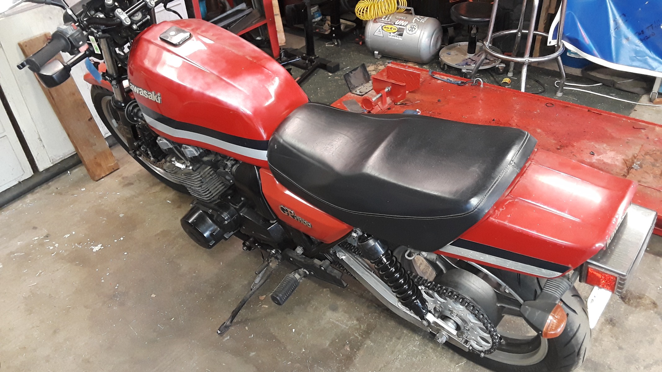

Guys,
I need your help again. I have about finished up the updates on my wife's GPz except that I need a cable.
Follow me now... The speedo is a Kawasaki ZN700 something or other made in the middle 80's. easy enough.
The front wheel & drive is from another mid 80's GPz 750.
Obviously the 2 never existed naturally in the wild. Is it just a matter of finding the right length cable, because all the tops and bottoms are the same? Or is it more complicated than that?
Oh... Picture to attract interest...

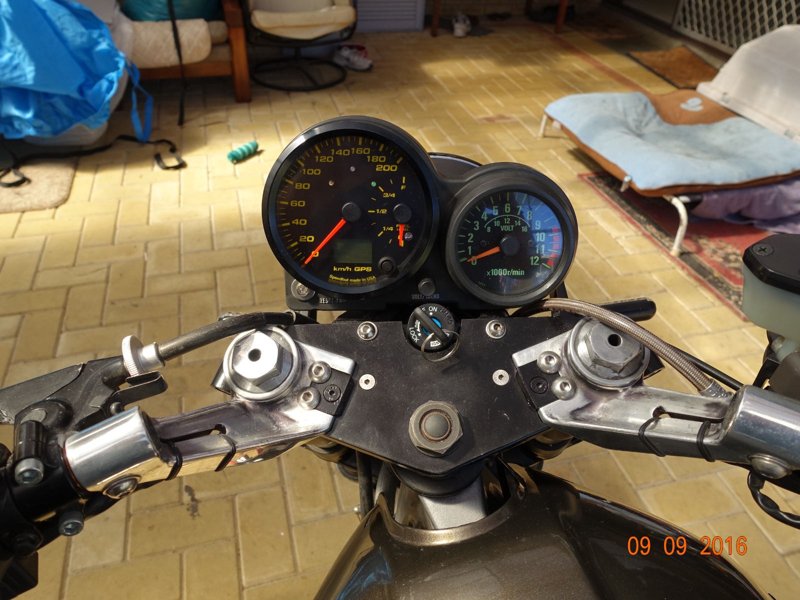

Looks Like you now have an 18 inch front wheel ? Why not use the later GPZ gauges that match the wheels, they look quite good on the early GPZ's . I'm using an 18 inch front oj my project and have a set of the later GPZ gauges, they aren't fitted yet but they look good mocked up..
Edit, that speedo is an aftermarket speed hut gauge, the Stock GPZ gauge is set up for 18 inch wheels...
