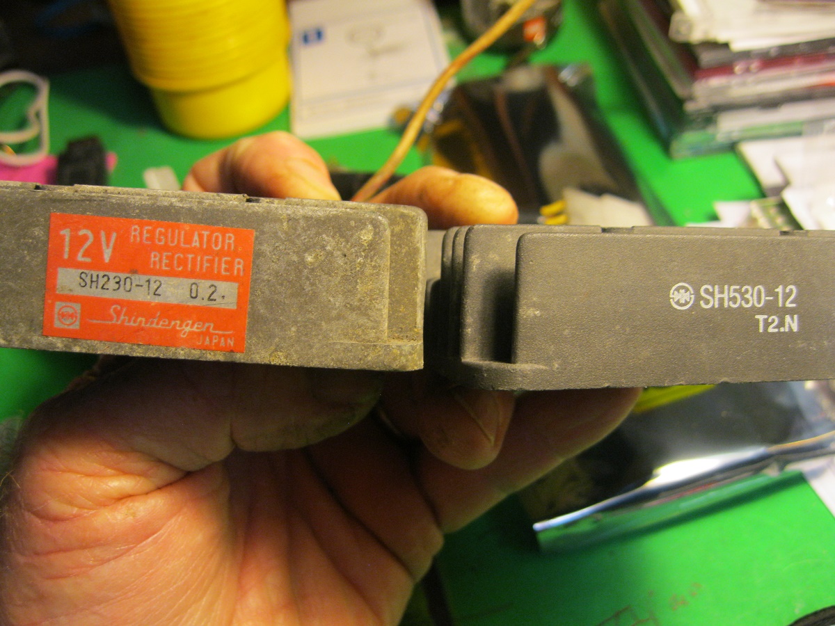

I have 1980 KZ750e1
A few years back I swapped out the old SH230-12 for a newer SH530-12 from an 05 or 06 EX500 Works just fine
The connector block on the newer unit was female and on the old was male . Not a big deal to fix

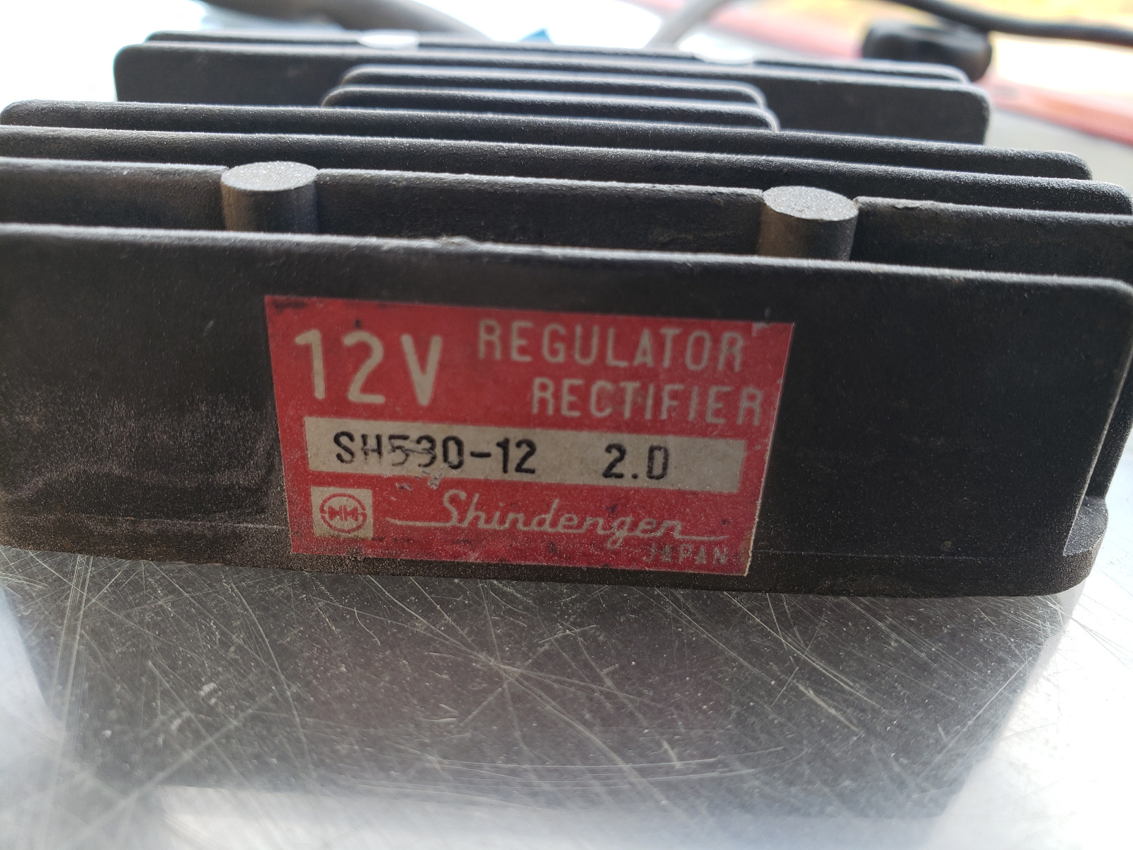

I'm not sure if this helps, but my bike came with 530 series and it's an 82 750. Wiring seems to be all the same.
