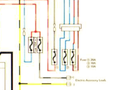

Your main fuse-
white wire(red/white wire) is supposed to be a 20 amp fuse.
The other fuses are 10 amp.
I'd use an AGX.

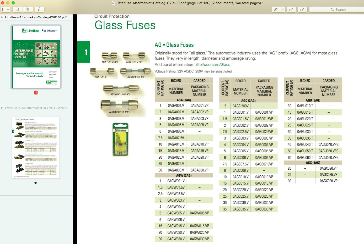

With glass fuses the letters describe different physical sizes.
The AGX is closest to stock.
Just get a voltage rating higher than 12V.
I'd use an AGX.

The Main fuse box uses 25mm fuses (AGX = 1/4 x 1") while the Acc fuses are 30mm (AGC = 1/4 x 1-1/4
I don't know why Kawasaki did that, having two different sized fuses. sure would be handy if they were the same.
Sometimes you can find fuses on EB. I haven't checked an auto parts store lately, but nowadays they don't have much, usually an assortment w a bunch of unneeded fuses.
