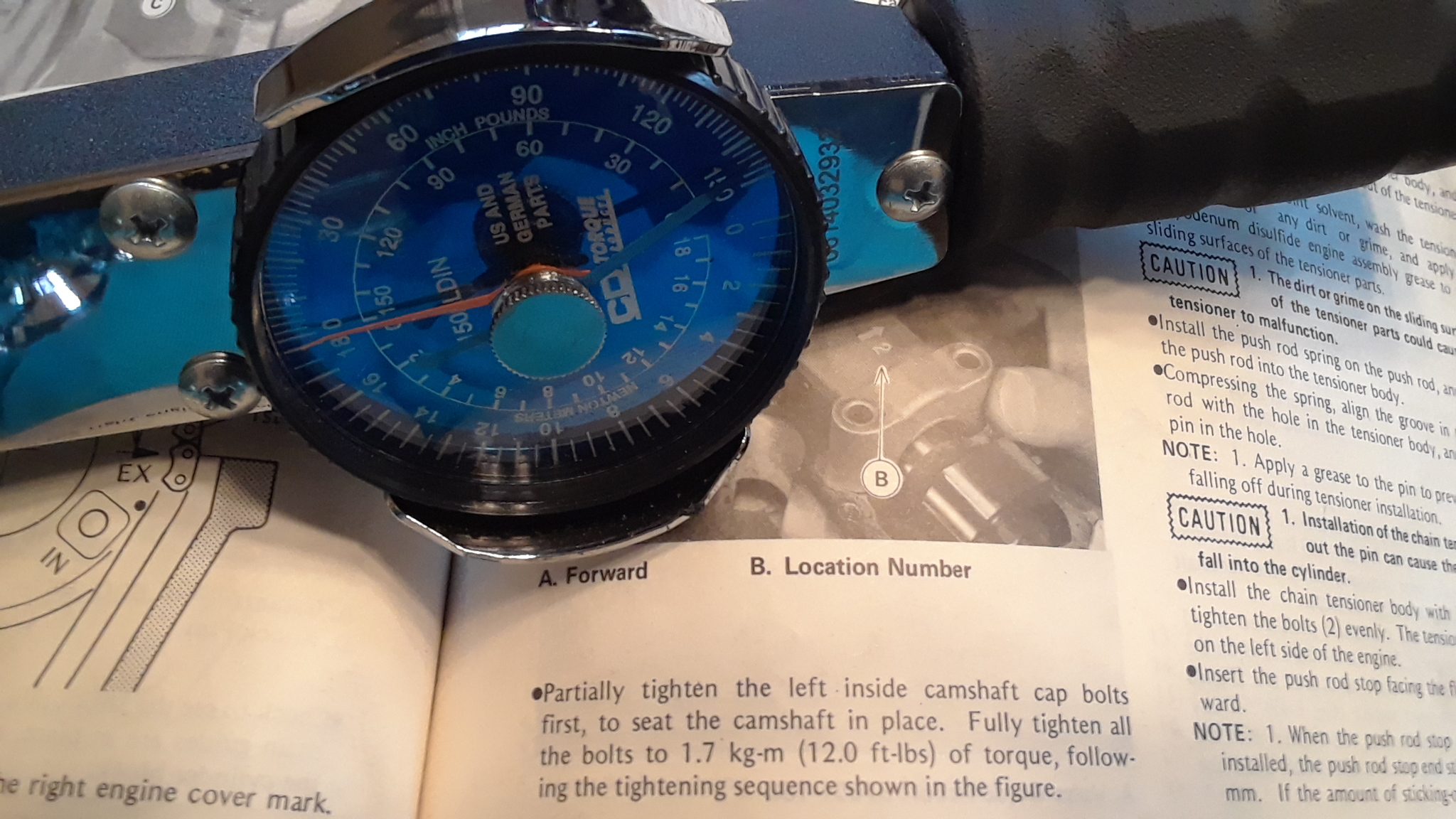

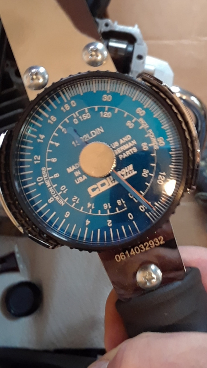

Regarding the FSM specified cam cap bolt torque question...
No problemo x16 bolts
