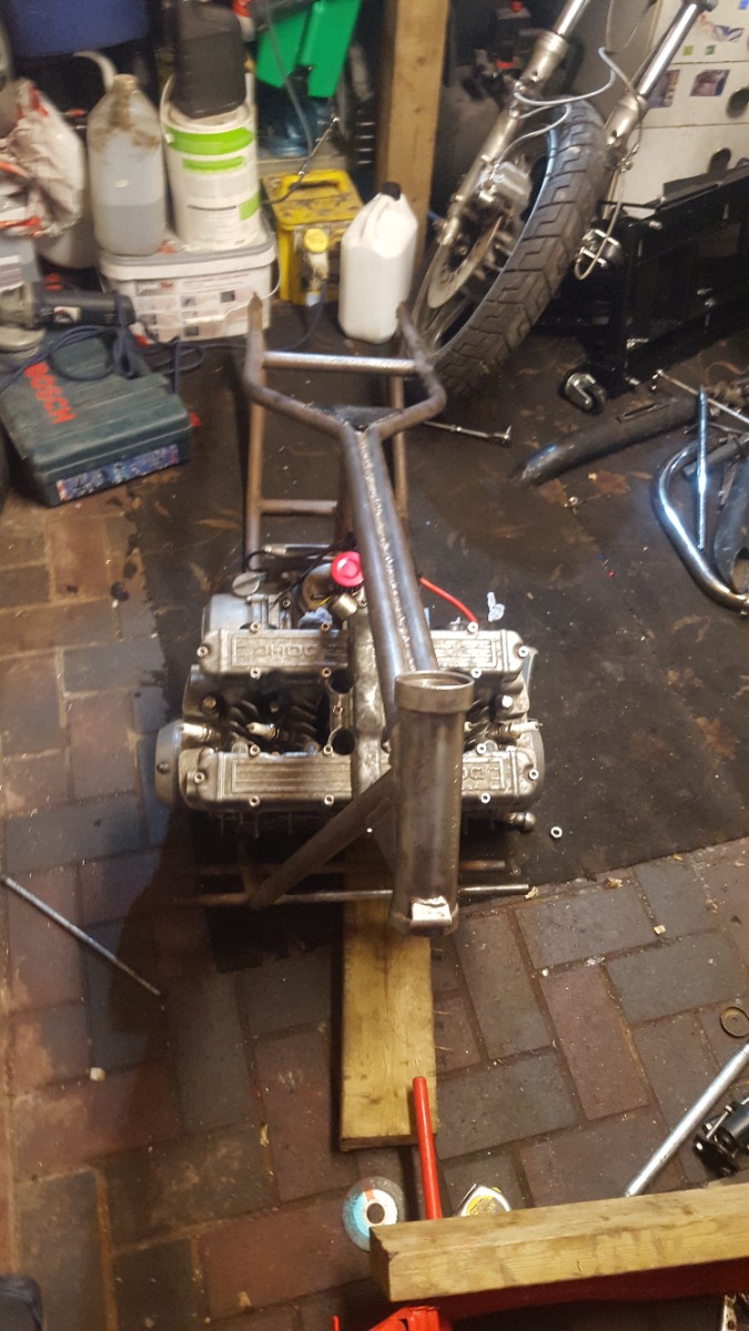

yes new would be good but i need a lot of new at the moment lol just trying to see if i can get engine to run. is there any diagrams that show basic wiring just to get engine to run leaving out ignition , kill switch , regulator rectifier nice and simple for simple guy like me
this is all i have at the mo
