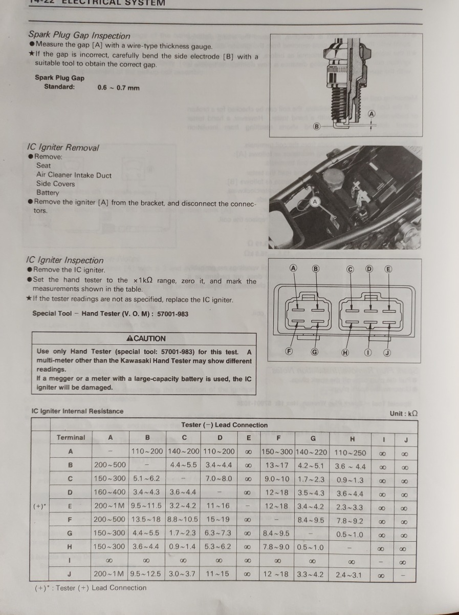

The third problem is that I think I have fried the ignitor. I did the resistance tests from the manual and they were completely off. I have a new (2nd hand) ignitor on the way but I want to be sure that I don't fry this one. As far as I can tell I should be running the following to the ignitor:

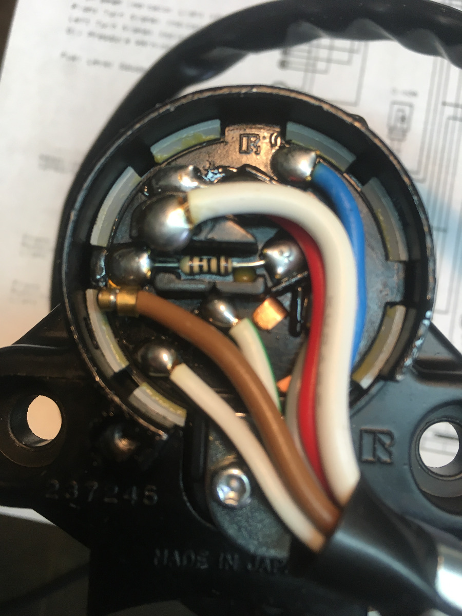

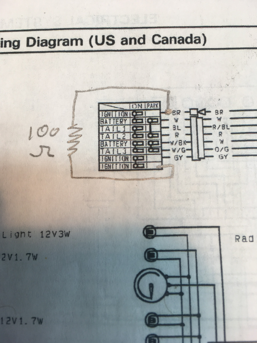

I will be replacing the ignition and need a resistor on the grey wire to drop the voltage. Does anyone know what I can use? Seems the ignition I have isn't working properly otherwise I would try pulling it apart and nicking the resistor...

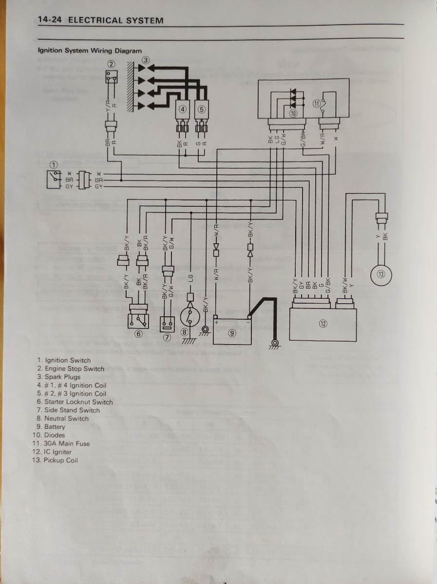

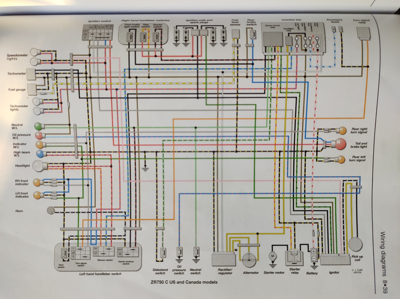

There are some diagrams below. As far as I can tell the green/black has to be connected to ground for the starter to work in the original setup. Does that mean it's the positive side of the relay switch circuit? Should I just not connect anything to it?

I don't really want to gain anything with a different ignition, I just figured if I have to replace the ignitor and the ignition switch is getting replaced (due to size) I might as well broaden the search. I wasn't planning on changing the coils or pickups, but if there was another model with a compatible ignitor and no grey wire...

The factory system is pretty bullet proof. A few ZRX folk have had trouble with the security system (grey wire), but most do not. My ZRX is 21 years old and starts on the button every time.
If the ZR750 is the same, and it appears to be, the igniter must have that tiny voltage from the grey wire to come on. If you need to change the ignition switch, then the grey wire needs to be connected to a switched 12v wire via a resistor. It is easy, and probably much less hassle than trying to wire in some other igniter.

The green/black wire on the igniter is a safety interlock. The first diagram does not show the green/black affecting the starter. It shows that under certain conditions, the igniter will not function. Grounding the green black wire of the igniter will bypass the safety systems and allow the igniter to work.
The starter system has it's own connections to those interlock switches, probably through a relay in that "junction box" shown in the second diagram. It appears you can bypass the starter safety system by connecting the yellow/red wire to the black/red wire. Those two wires are seen at the "junction box".

@loudhvx: you're right, thanks. I originally thought this but then somehow combined the two diagrams in my head. But if it was part of a relay switch for the starter then there would be a coil in the first diagramm.

The first diagram omits the starter-related items. Notice the starter wires are not even included. There could be a relay in the junction box, but it won't be shown in the first diagram because it's not strictly ignition-related (which is the purpose of the first diagram). The second diagram only shows it as a box.
The coil of the relay would be fed 12v by the black/red wire. The ground of the coil would be established through the various safety switches. The contacts of the relay would also be fed by the black/red wire. The contacts would then feed 12v to the yellow/red wire to energize the starter relay.
It could be done other ways too, including transistors or other solid state devices. Since it's drawn as a simple box, one would have to open it, or perform other tests, to know what's inside.

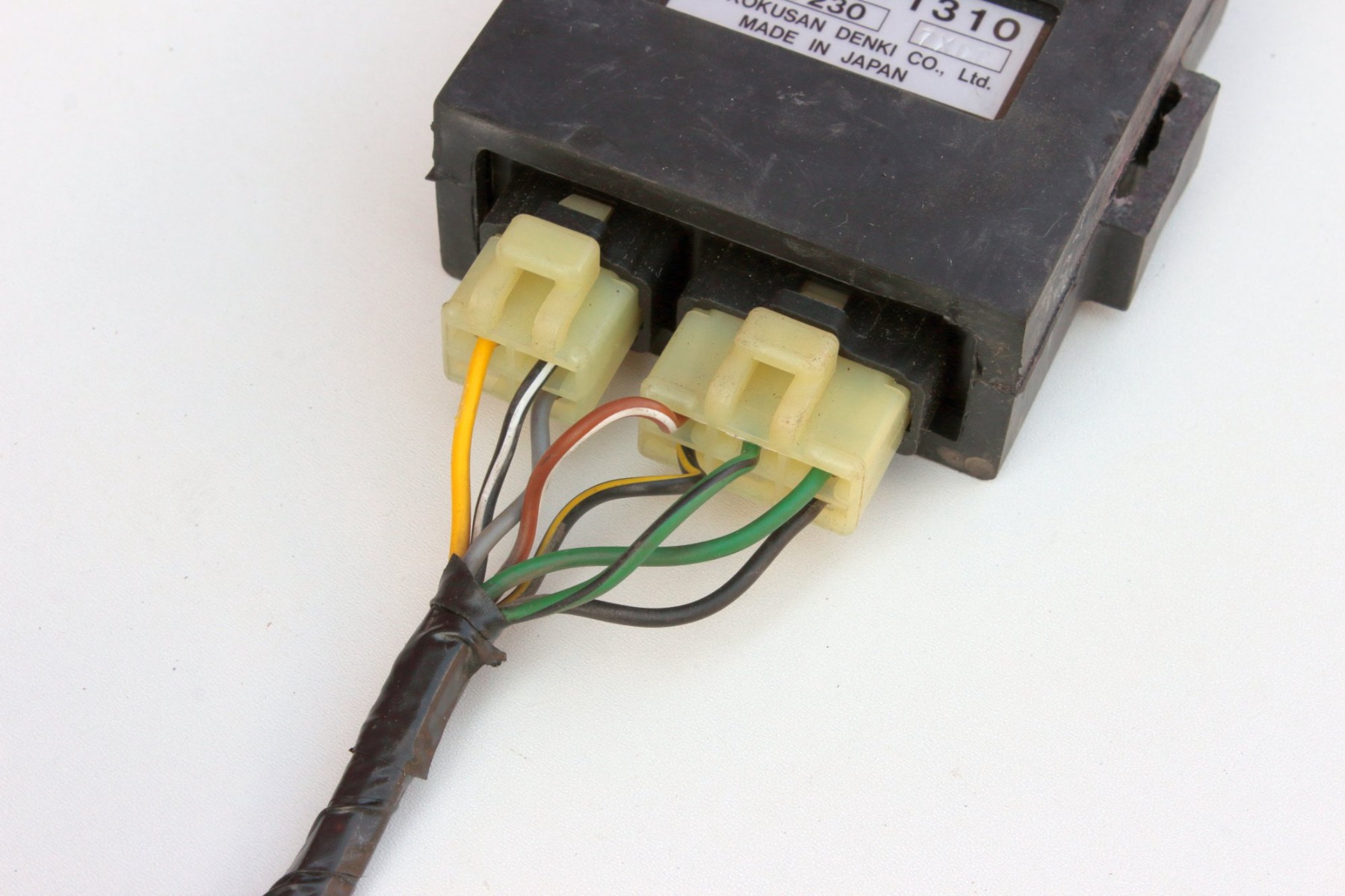

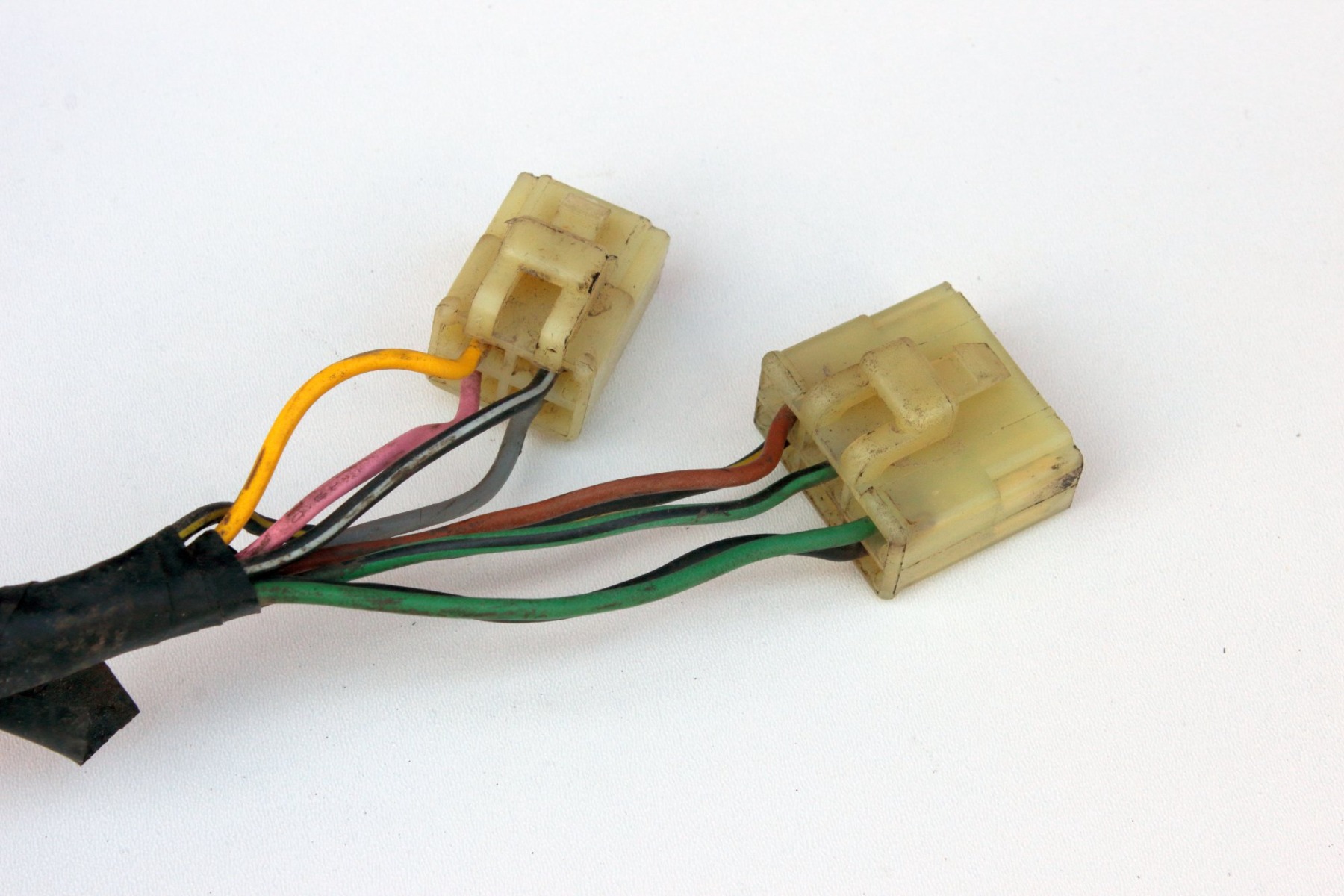

Got an email from gazzz with the last piece of the puzzle today. Once I knew where the wires were supposed to go all I had to do was wire it up and she fired up no worries
I guess the grey wire had 12V on all the previous tests as I had it connected to the wrong terminal and the circuit wasn't closed. It does still seem strange that the ignitor failed almost all the resistance tests. I guess I need to check my multimeter
Anyway, for anyone that "accidently" removes the grey wire, here's a photo from gazzz of the ignitor(igniter?) connectors (connecters?):

I never gave much credence to resistance tests on things like igniters. Resistance test results on non-linear semiconductors require the meters to be exactly the same as the original test meter, which is unrealistic considering how many different ways you can design a meter. It also requires the manufacturer never changes the igniter design, which is also unrealistic. Small electronic devices can be made many different ways to perform the same task, so a subcontractor can easily change a design to improve operation or save money.
Resistance checks are really only good for things that act like resistors. Most electronic components don't really act like resistors, though you can still get a resistance reading for a specific type meter.
