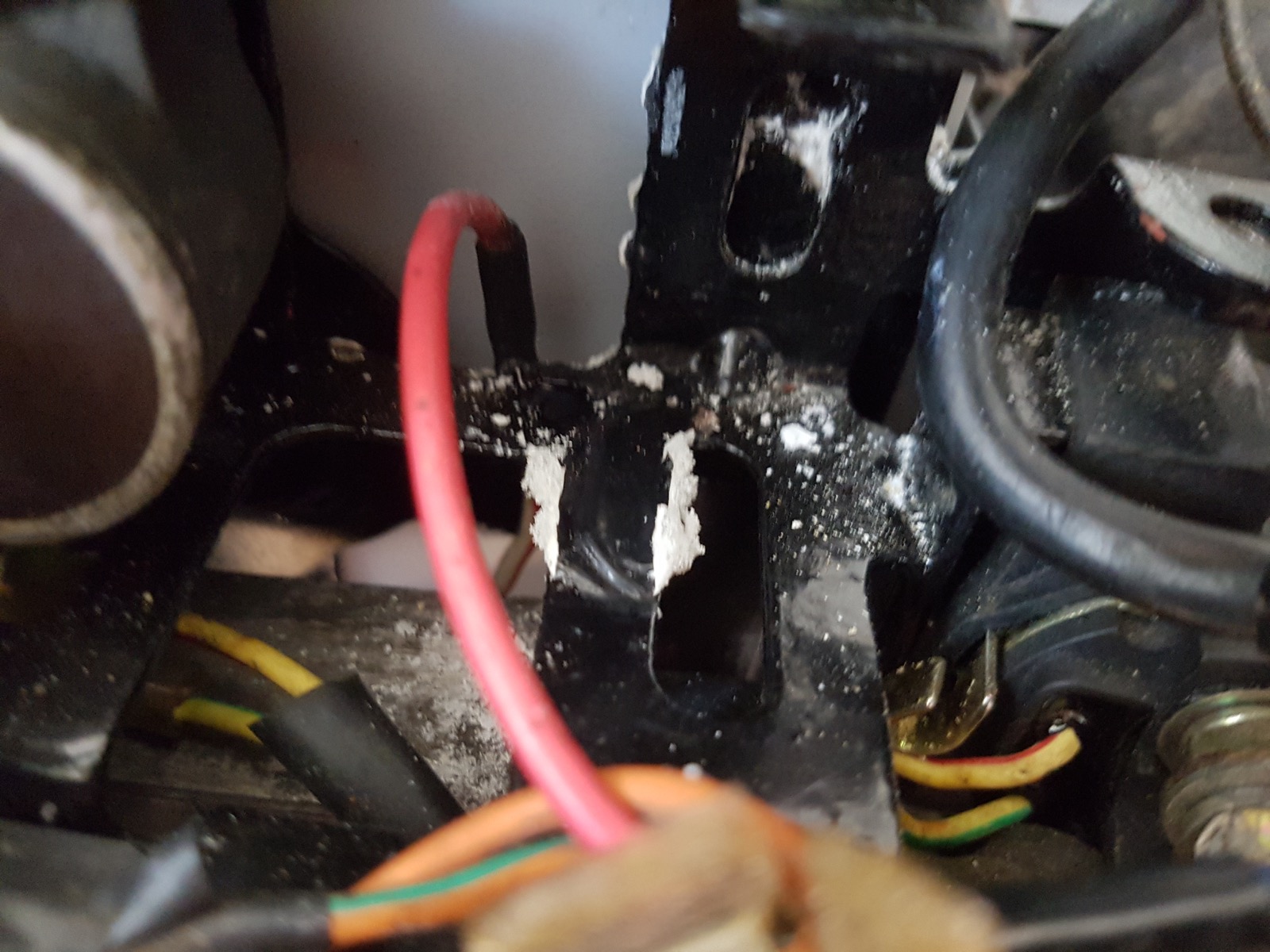

Potential problem locations: I'm thinking the problem could be a few things. I'm very new to working on things so you'll have to excuse any ignorance. When I opened the bike up I was surprised to find a bunch of the white fluff (oxidization?) had reappeared under my paint (Pic #1). I'm thinking this has to be electrical because I stripped and painted all the internal metal electrical holsters less than 7 months ago.

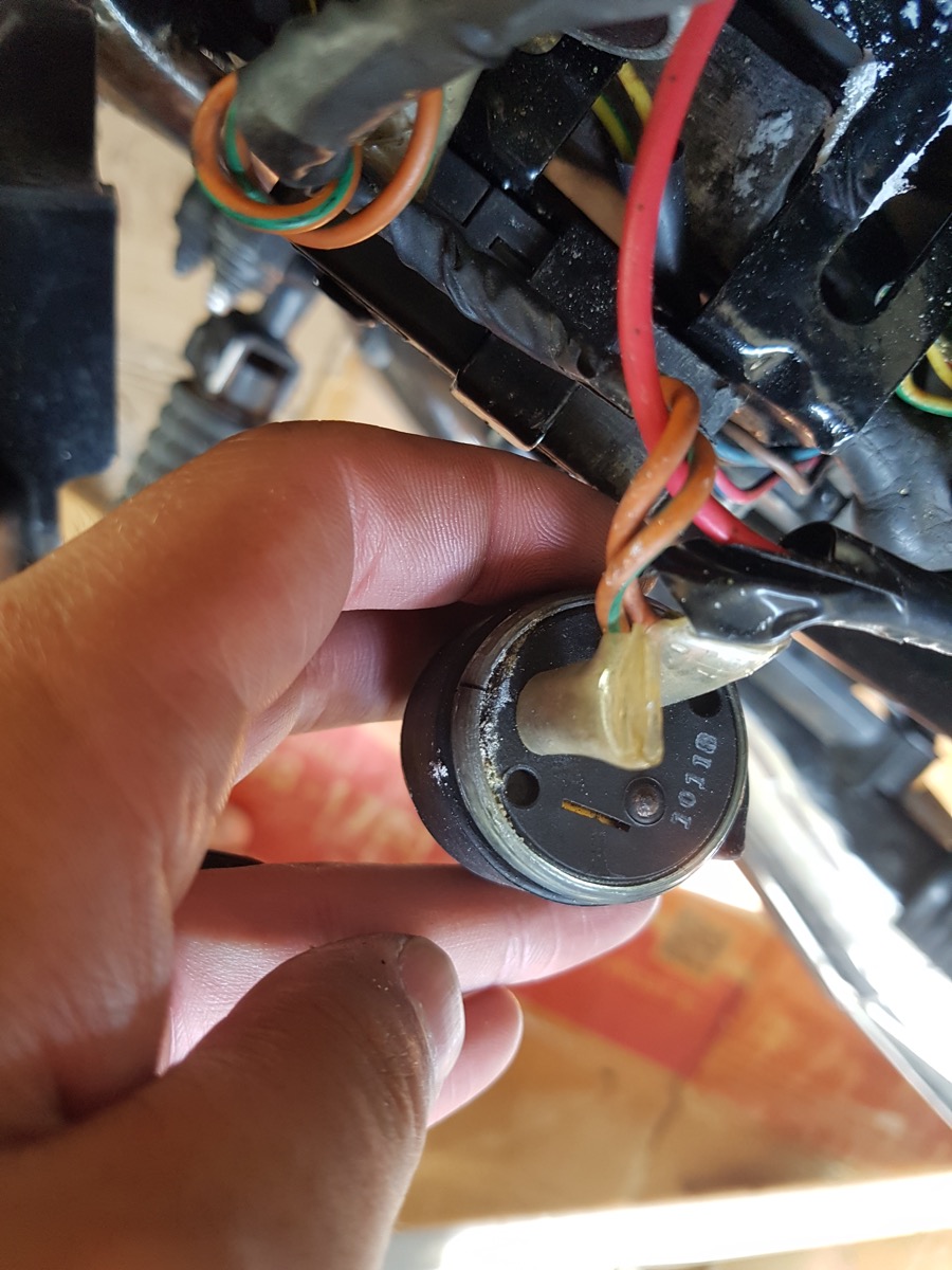

My first guess was that the relay was gone (pic #2)

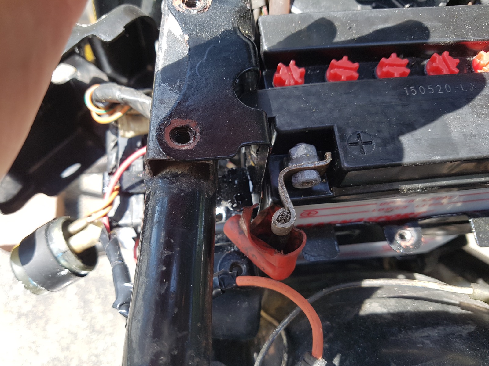

but then I noticed that my positive battery hookup (the main power source) had lost its jacket and was exposed (pic #3),
so perhaps it was hitting the frame and shorting something?

The white stuff is sulfur dioxide and it´s very etchy, (boiled overload battery). Give all electical parts in the area like, connectors, plugs, wiring bullet and spat connectors a good clean with a brass brush and WD40. Unplug all connectors to look closer for oxidations that create restiction to the power flow. In worst case you have to pinout the connertors to get a better access for cleaning.

The thing is I don't see any battery spillage like drips from the battery itself. The white stuff seems to be coming from inside the metal (under the paint.)

The relay in pic 2 looks like hazard (4 way flasher) relay. Mine has 2 orange green wires. Unlikely to be the cause of problem.

1. Corrosion. You are probably right that the corrosion in the first picture was caused by battery acid. It came back because it was not completely removed and neutralized the first time. I think the best way to save the battery box will be to completely remove it, strip the paint, soak it in a strong baking soda solution and scrub it with a brush. Fiercely. When you are sure every spec of corrosion is gone, rinse it with clean water, dry it quickly and apply a good primer. When that is properly dry, apply several light coats of high quality paint.
Take a shop vac to the rest of the corrosion in the bike. Use a fairly soft brush to knock loose as much as you can while vacuuming. Once the loose stuff is gone, you can make a paste of baking soda and water and use a toothbrush to vigorously brush the remaining corrosion, then carefully rinse with cold water and blow dry.

3. Battery terminal cover. It is not really needed as long as the battery is properly tied down and you do not do something silly like touch it and the frame at the same time with a wrench or screwdriver. The battery really needs to be properly tied down for its own health and your safety. If the battery has not been tied down, it could be splashing acid all over the place while you ride. When it is time to replace the battery, I suggest an AGM. They are sealed and a good one will last many years.
