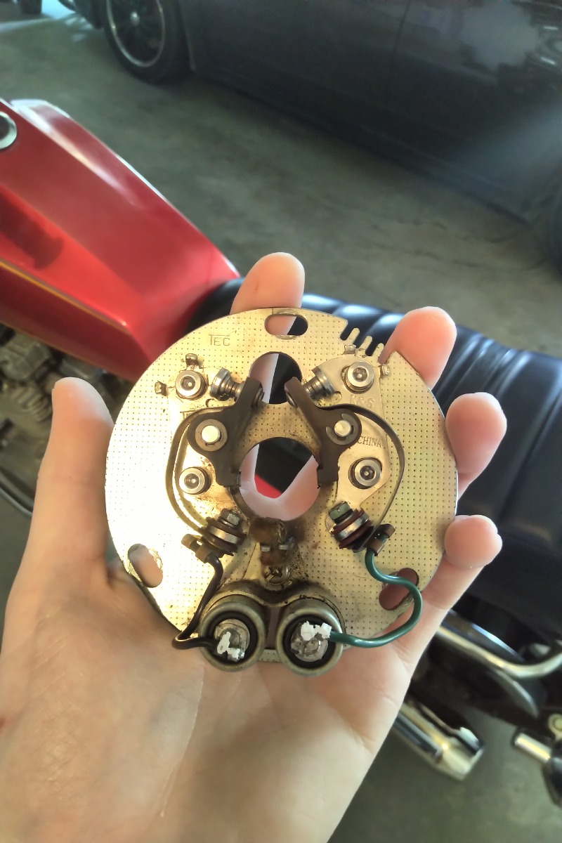

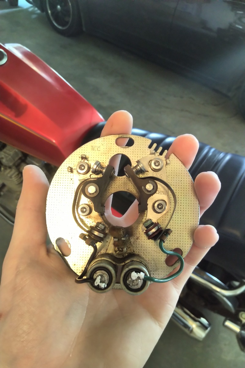

I have also purchased points off Z1 enterprises a few months ago. The points they sent did not fit unless I filed the rubbing block down to allow the dwell to be set in spec. I wrote a review saying they were Chinese junk that didn't fit, but my review was deleted.
Buy by part number or buy NOS. Z1 sells the same junk fleabay does but no free shipping.
I swapped my points plate for an older model one that would allow me to set timing on each point, Here is my old one with a junk point fitted on the right and an OEM one on the left.
As you can see its made in china. The rubbing block needed a lot filed off, and the geometry is different, so I wouldn't set dwell by setting gap because the change in geometry would change that. You would need to use a dwell meter.
