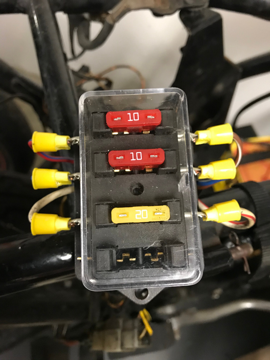

I went this route to avoid the Buss fuse availability issue:
The block itself was about $7 on Amazon.

I hope you put some heat shrink over those connectors. Thats a short waiting to happen.,

Not if the fuse box is in its own housing.
The airbox is gone; the battery and other electrics will live in their own enclosure between the frame tubes.
