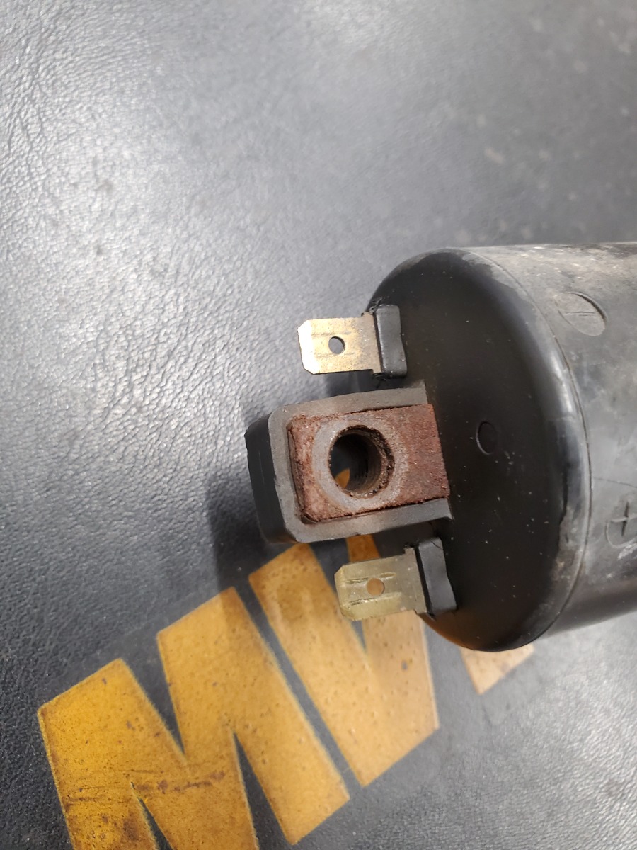

Ok stupid question finally got some time to get in the garage again and got.the new coils only took a week to get here. Took the on that was not firing off and found a lot of rust on the two post that connect to bracket could that have caused it to fail? Is it something I should be concerned of for future? Thanks guys

Good question, I think not, let’s see what the experts say. I’m sure the windings are isolated from the mounts. The coil is grounded and charged by the points or pickups = dwell.

Im thinking the same thing but kinda wanted to check and see. Had to go find new hardware destroyed one pretty good trying to get it off and noticed both of them had a slight warp in them so figured fix it right

The primary and secondary coil wiring are isolated from the metal core, so a little rust on the outside surface didn´t harm the function.
The metal core is for routing and amplify the magnetic field lines.
