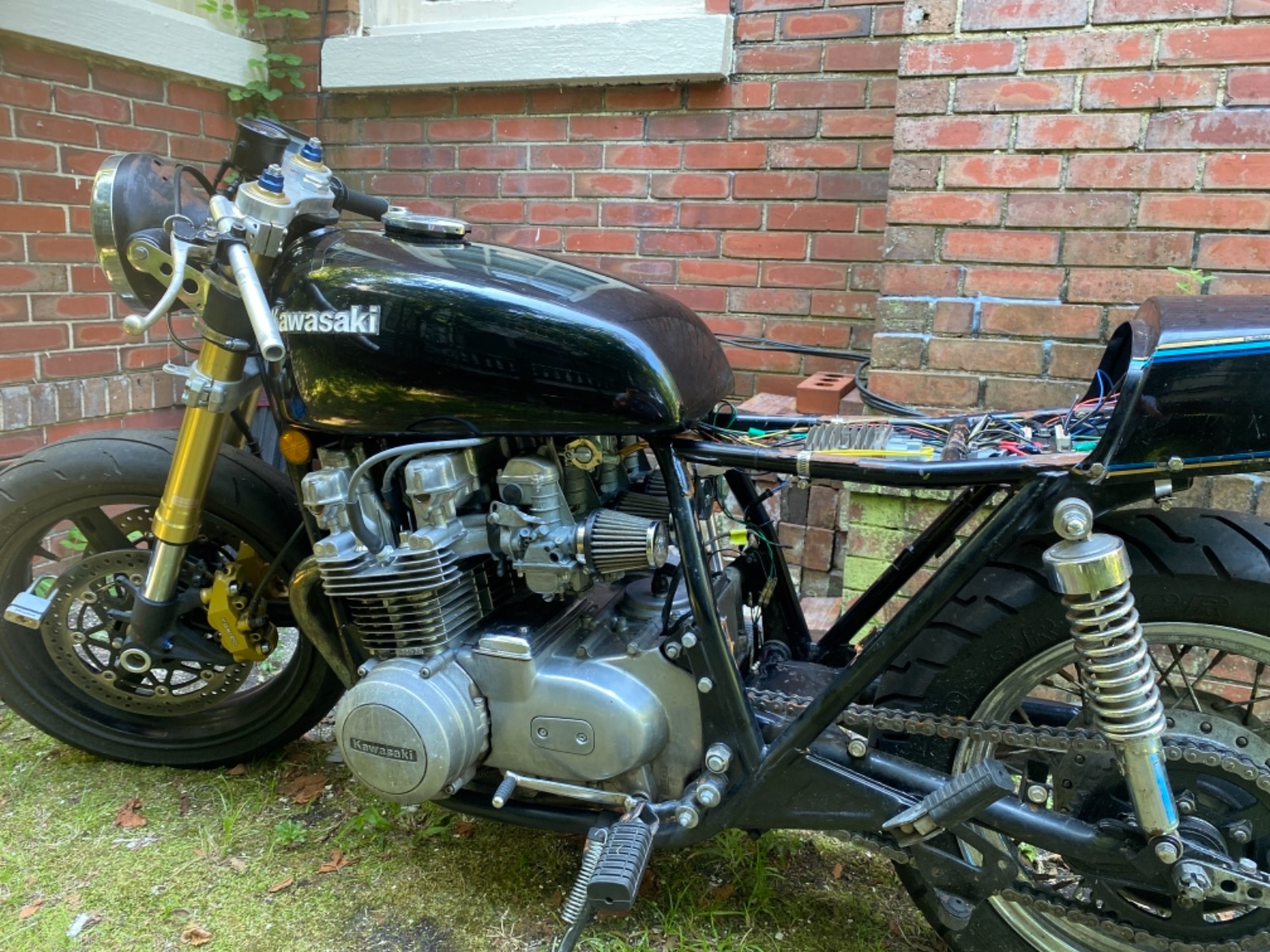

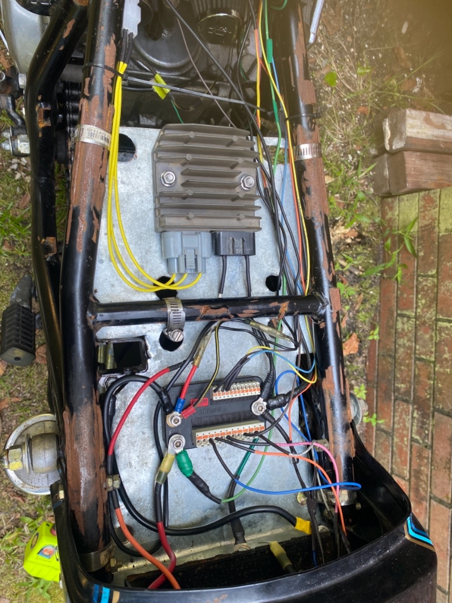

Hey guys, so I'm still wrenching on my kz 650. I rebuilt the top end and reused the old wiring harness and electrics and got it running!! However, my plan had always been to upgrade to a lithium ion battery and an m unit. So I took out the old wiring harness and have, to the best of my knowledge, wired the bike correctly. Lights are working, I'm getting power to my dyna 3 ohm coils.
My plan was to install the dyna S electronic ignition which I did, but was having trouble setting the timing... I couldn't get my testing light to turn off. Basically it was showing power to the coils constantly, even when turning the engine over by hand. So I switched back to the points for now.
. To simplify things I decided to ditch the start button and make it kickstart only. It is wired and I try to kick start. I'm not getting much signs of life except for the occasional back fire. It's like it's not even close to starting!!!
. So my first thought is I'm not getting a spark. However I'm having trouble testing for a spark now that I don't have a push button starter. Any suggestions on this? Also any suggestions in general would help! I know I'm really close but I'm missing something, maybe I need to dig into the stator a little more?
. I did upgrade the reg/rec for my anti gravity battery which is brand new. Coils are getting power, but I'm not sure that's translating into a good spark. One other thing, the ground wire that used to go to the starter, can I now remove that, or should I run that to ground on my battery? My guess is I don't need it but at this point I really don't know if it could be the reason I'm not getting this thing running.

The starter wire is not a ground. It provides positive battery power through the solenoid. The starter motor body is the ground.
Make sure you have a kill switch for the Dyna S. You can burn out those coils if left powered too long without the engine running.
