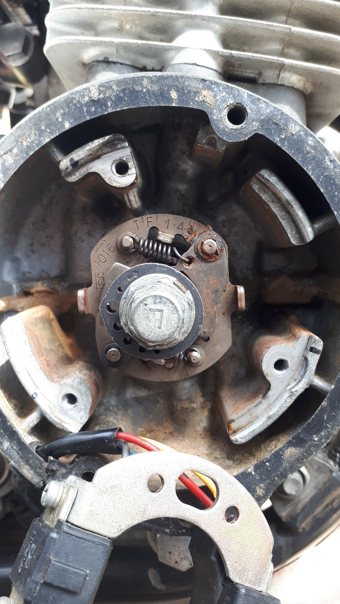

Thanks for the photos. Great looking bike, by the way.
The cam timing looks good to me.

The 550 (and all inline-four Kz's, actually) originally came with the black wire controlling the coil for cylinders 1 & 4, and the green wire controlling the cylinders for 2 & 3. But if someone flips the timing rotor 180 degrees, then the wires will fire the opposite pair of coils.
As a side note, on the smaller motors, the coil with the black wire is mounted on the right side, whereas on the big motors (900 and up) it's mounted on the left side. It's good to keep things in the stock location (and the rotor in the correct orientation) to make troubleshooting less confusing.
There is a point on the timing rotor. It should be pointing toward the "TEC" logo on the advancer unit. It'll take a flashlight etc to get a look at the advancer unit. You should check the ignition timing advancer anyway. If it's stuck advanced, that'll make starting difficult. And if it's stuck retarded, it will only get up to a certain RPM and bog. You want to make sure it's free and able to snap back easily and both springs are intact. Also there are tiny rubber cushions on the arms that sometimes fall off and alter timing a bit.

I believe this is a pic I took of the advancer when at TDC #1

I see the pickups have been unbolted from the timing plate. The magnet orientation is important. This page will show how to get the magnets installed correctly.
s3.amazonaws.com/gpzweb/Ignition/PickupA.../PickupAndRotor.html
If you have to roll the throttle slowly to get past a bog, that usually indicates it's too rich at the point of the bog.
Are you still using the original factory throttle needles? Some counterfeit ones look almost identical, but they are slightly too skinny and end up way too rich. The area of concern would be the early part of the throttle rotation. That is where the pilot jets and needle position matter most. The main jets will only slightly affect that range.
Once you get to full throttle does it run ok?
