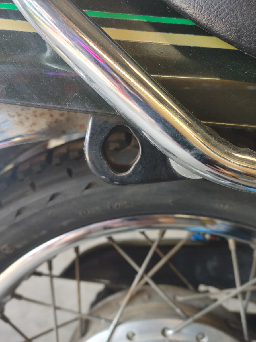

This is probably a dumb question, but I have to ask it to be certain. See attached photo of my bike, which is a 76' KZ900. I'm not worried about the wiring/circuitry, but more about the physical parts I'm missing.
The bike has no blinkers. I'm searching for parts now and am having a hard time putting all the little pieces in my cart to make sure I've got everything I need. I've even looked at the parts diagram and I'm still kind of confused!
I know for sure I need:
- Turn signals (single wire? or double?)
- Stems
- What else?
So Z1parts sells a kit of 4 lights and stems.
z1parts.net/turn-signals-stems-z1-kz-h1-h2/
But I know there is some sort of rubber bushings, right?
This is complete for everything I would need for front, correct? z1parts.net/headlight-grommet-set-z1-kz-h1-h2-kh/
This is complete with everything I need for the rear, correct? www.z1enterprises.com/rr-turn-signal-gro...00-1000-650-400.html
Thanks for the help!

This will help with the rear. They are the ones with the ground wire.
www.partzilla.com/catalog/kawasaki/motor...z900-a4/turn-signals
Then look here for the front headlight bucket. Ad to the upper two shown on the above link.
www.partzilla.com/catalog/kawasaki/motor...6/kz900-a4/headlight

z1parts.net/turn-signals-stems-z1-kz-h1-h2/ This is wrong. The ‘76 900 uses single wire turn signals front and rear.
This is complete for everything I would need for front, correct? z1parts.net/headlight-grommet-set-z1-kz-h1-h2-kh/ Need to look at this closer, appears to have wrong grommets
This is complete with everything I need for the rear, correct? www.z1enterprises.com/rr-turn-signal-gro...00-1000-650-400.html This looks correct.

No eBay APP ID and/or Cert ID defined in Kunena configurationNo eBay APP ID and/or Cert ID defined in Kunena configurationFront;
- 23076-005 x 2
- 23066-016 x 2
- 23066-015 x 2
- 92075-128 x 2
- 315B1000 x 2
- stem x 2
- housing and lens single wire x 2
- 92075-128 x 2
- 92075-158 x 2
- 92027-147 x 2
- 92022-239 x 2
- 26011-063 x 2
- 461F1000 x 2
- 315B1000 x 2
- stem x 2

I'm pretty sure the light kit from Z1parts that I posted will work. There is a drop down menu to choose between single wire or double, and I chose the single wire.
I ordered the rear rubber bushing kit from Z1enterprise since it sounds like it was the complete kit. I haven't ordered the front kit yet. My bike currently has two plastic/rubber plugs on the sides of the headlight, I'm assuming those come out and that's where the front turn signals will go.
Thanks again!
Thanks again!
