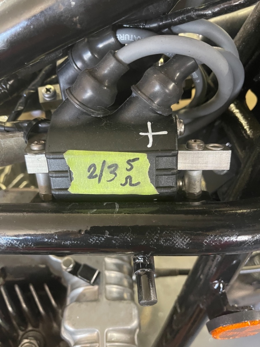

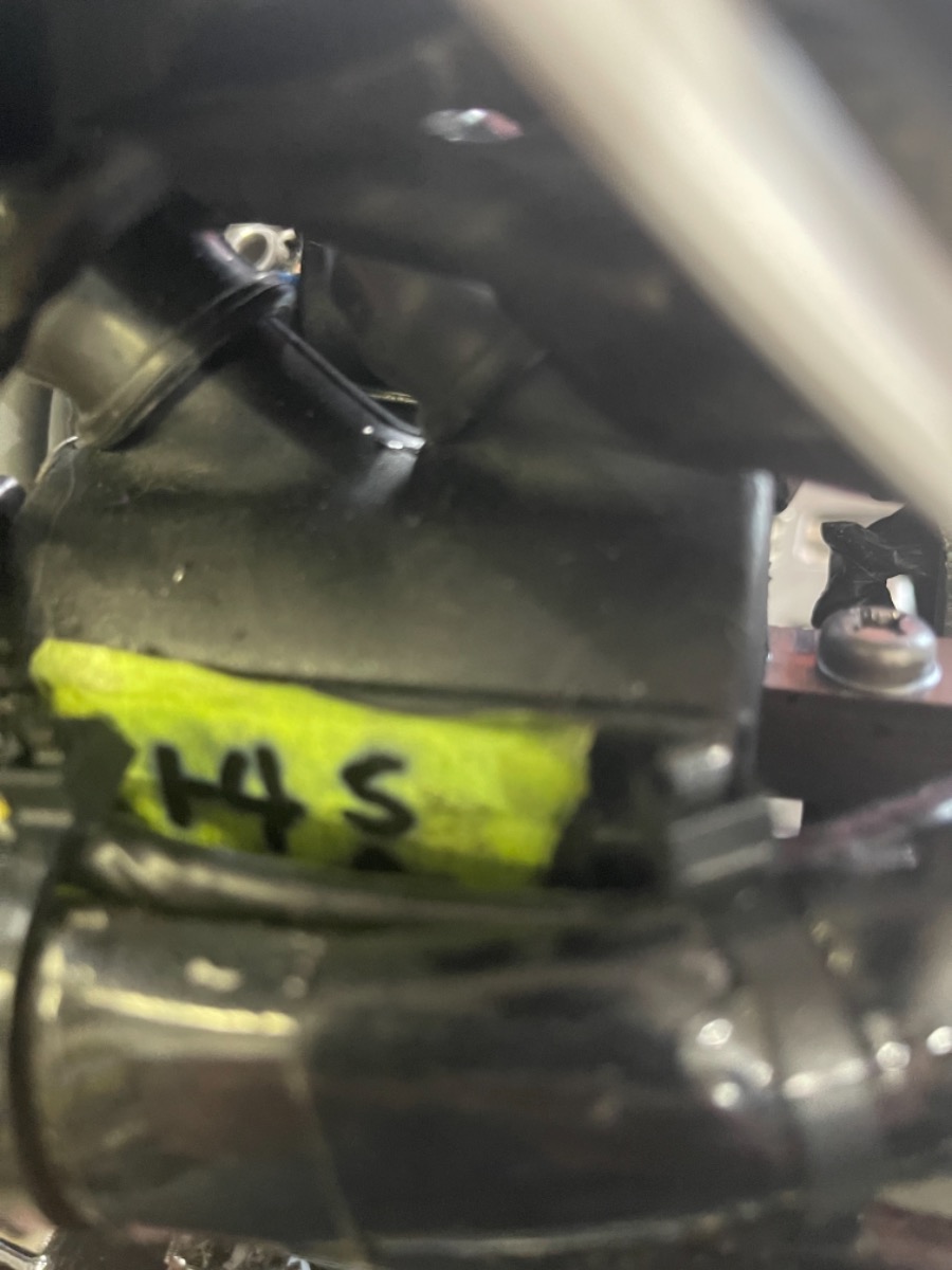

Hello to all,
I’m new to the group. Have a 1976 KZ900A a new restoration. I’m building the wires to go from coil to plugs. On my old coils that were broken. So if you look at the old ones. There is a long indentation and a short one 1-4 2-3 the same. So on these dual output coils magna is the maker. So should I put #4 on the output on the back than #1 in the front. Same for #3 in the back # 2 in the front. Are does it even matter. Tithe ignition is dyna s. I’m on my phone so if you respond it may take me a minute too type any help would be greatly appreciated. Lee attached pictures of coils

Wire placement should not matter , Front or back fire together

On coil 1-4 it does not matter which way round the two leads go to 1 and 4 plugs.
The same applies for coil 2-3.
Also make sure there is sufficient clearance between the front mounting post and the lower coil terminal.
Too close and it may short.
