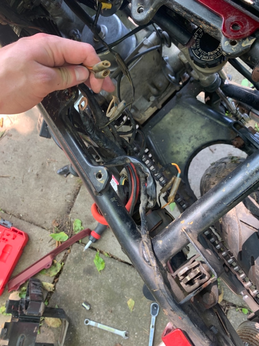

13 Jun 2021 08:16Please Log in or Create an account to join the conversation.

Those appear to be the wires that go to the flasher.
TexasKZ called it.
Orange and brown.
If you switch on your left or right turn signal and connect those two wires together, you will get a steady on light.
Put a flasher relay in and you should be good.

Can I put just any 2-pin 12 volt flasher in as long as it’s at or above the wattage listed in the wiring diagram?

Re: Trouble with turn signals- 1979 KZ750B
14 Jun 2021 08:39
Yeah, should be fine.
Unless you are running led turn signals. Then you may need a solid state flasher.
14 Jun 2021 08:54
I’ve had good luck with these. Will work with both LED and incandescent
