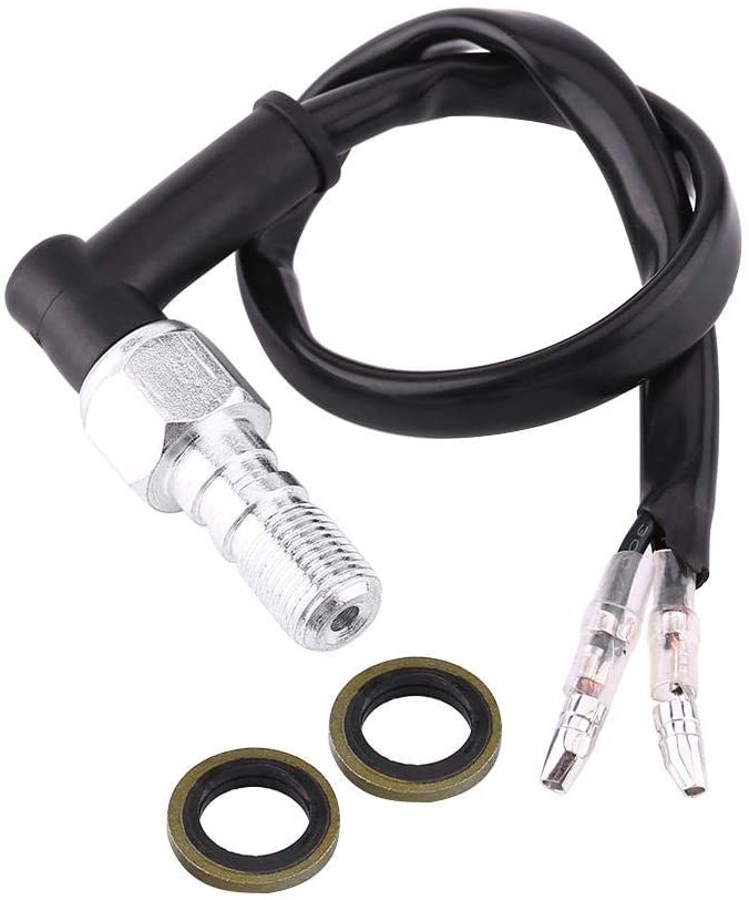

By Dutch_220: ... but the brake light wiring connection is different (2 connectors) ...
I don't see where that master cylinder has a brake light switch. If it does, just unplug the old brake light wires then connect new between the wire harness & new Br switch terminals. I installed a Honda m/c w modern brake light switch & used the wire lead assy from a KZ1000P police bike. The wire colors were the same & the terminals matched. I could have made the little harness, but the prefabbed unit was easier.
note: I didn't need the switch in the pic. just the wire harness.
