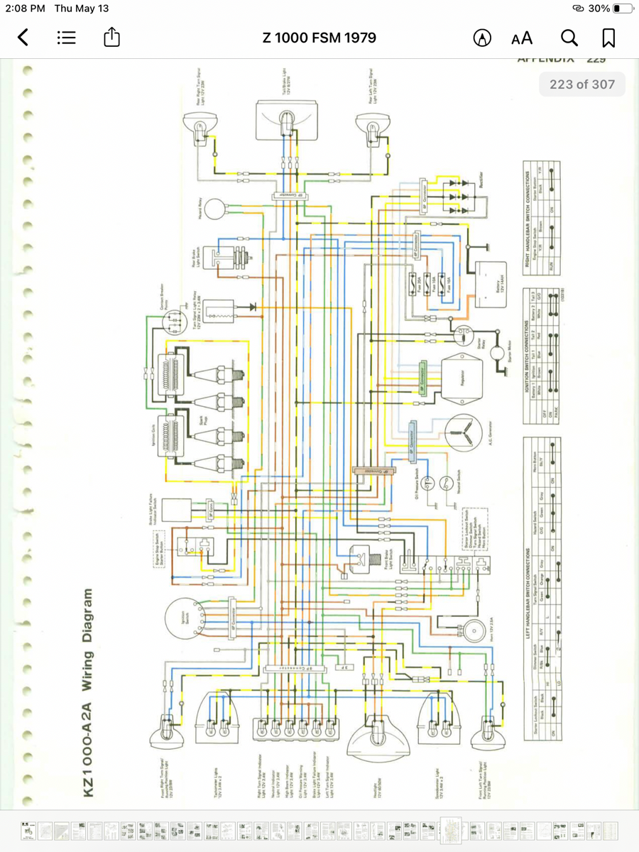

Check the clutch interlock, 2 black wires. One crosses over to the start button and the other goes to the start relay. Start with making sure those are all connected and corrosion free
Re: 77 ltd1000
13 May 2021 11:10
This for an A but should be the same
I have a ‘77 supplement at home I’ll dig it up later this evening

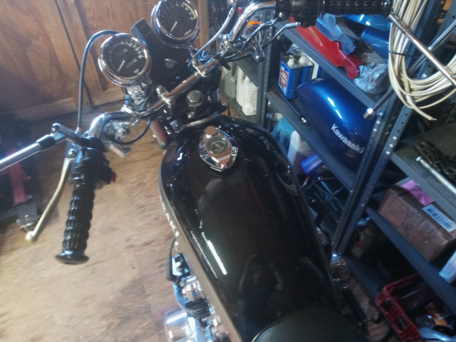

Liking the tank cap gauge. Do they really work?
- ronnieV
- Posts: 492
- Thanks: 593
Re: 77 ltd1000
15 May 2021 08:53
Sort of,kinda,uh,not really.lol when it's low u can believe it.
Re: 77 ltd1000
15 May 2021 09:03
Well it looks good. Maybe it should just be a clock!
