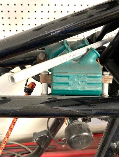

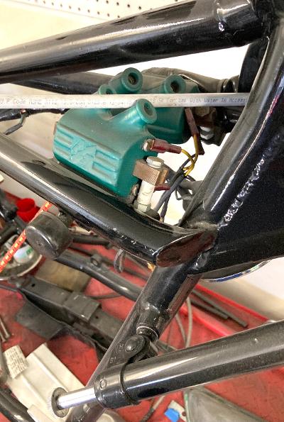

And for the mount posts next to the screws on the dyna coils! A $2.49 - 12" - 1/4" bathroom sink supply line! Works just fine. I might have even used 1/4" bolts to mount these dyna coils many yrs. ago?. 2" will cover both the nuts at bottom.

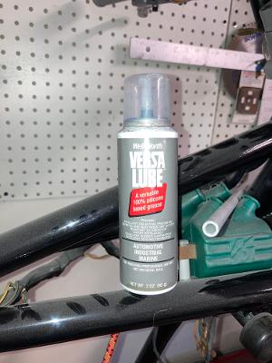

Plus I use a heavy, professional di-electric 100% silicone grease on all my connections and plug boots. Works great on the old Hemi Gassers with magnetos.
