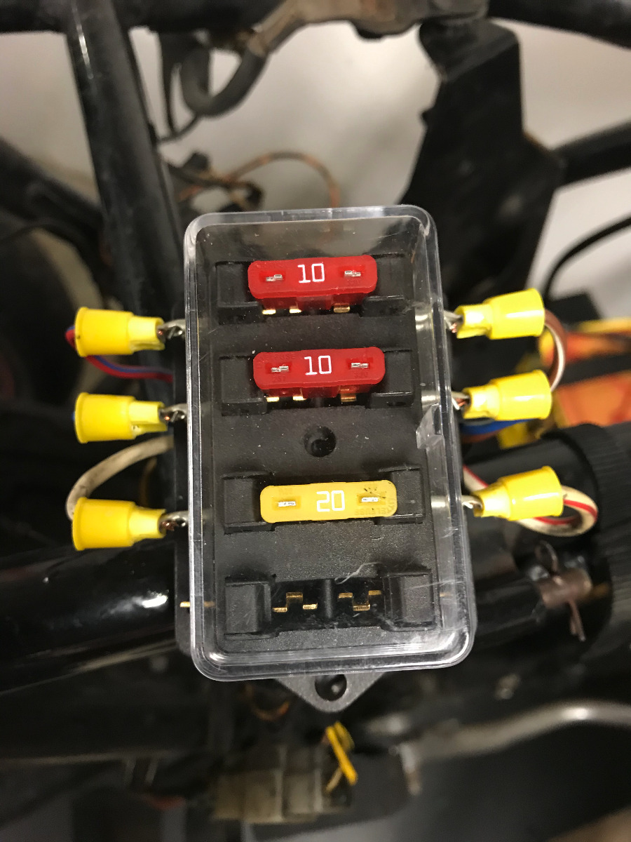

I replaced only the main 20A fuse in my fuse box with an in-line blade holder. I still use the original 10A glass fuses. As you may have found, 20A is too much for the wiring in the stock fuse box, and the wires and plastic clips melt before the fuse blows.
This is an example of the in-line fuse holder I used, but I have no idea if this specific one is any good: www.amazon.com/dp/B07DHLKSNY/
You can remove the existing fuse box and splice this into the existing wires in place of the 20A main fuse clips, and then plug the box back in.

Shade2k76: this won't be much help, but CreativeWiringSolutions was one place where a direct swap blade fuse box was sold, but the original site is gone & the new site doesn't work. Their fuse box was similar to the one Nerdy installed, but it had the stock type connector & wiring plus it was waterproof. Maybe someone else sells something similar. ??? I did some basic searches but didn't have any luck.

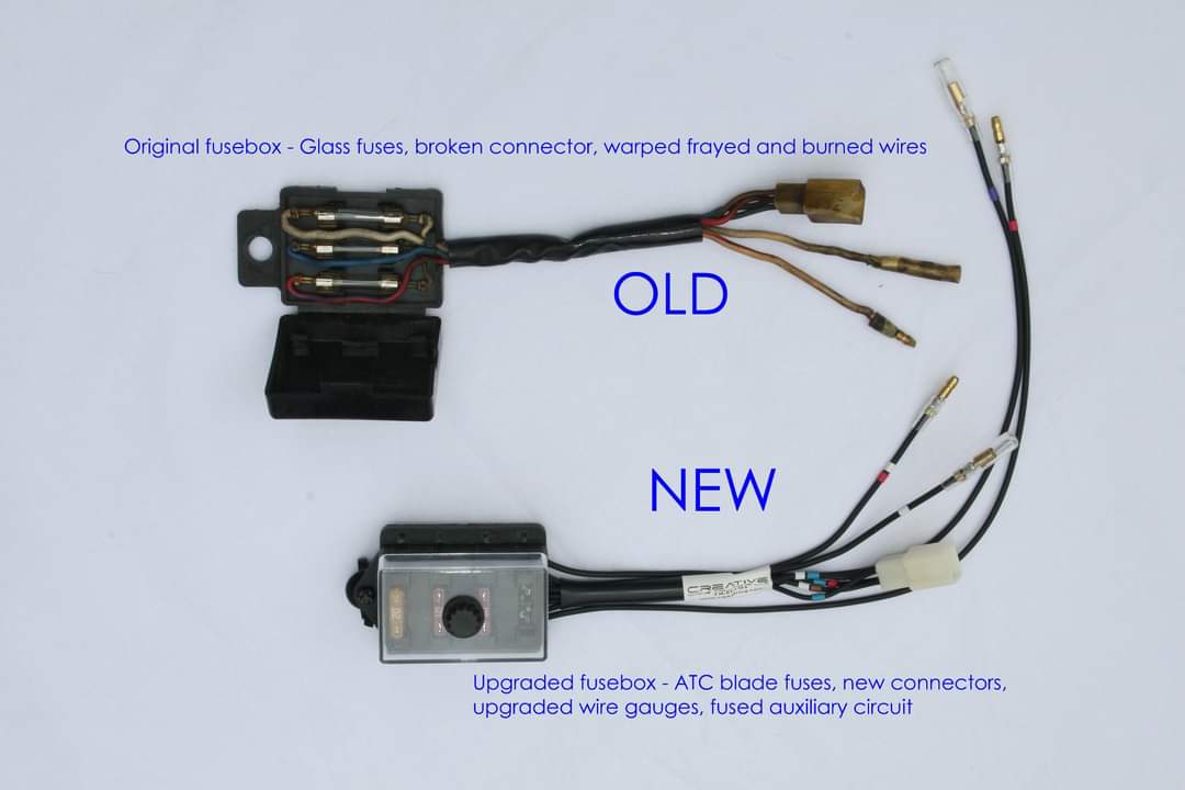

Creative Wiring Solutions website is here:
cwswiring.com/home-page
He seems to have started upgrading his website in the fall, but there's been no movement since.
Here's a picture of his upgraded fuse box:

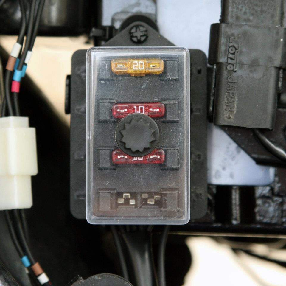

I know I'm a bit late getting into this but I've been away from the KZ scene for a while so, apologies all around. Watching Allen Millyard build his 6 cylinder Z1 on YouTube gave me the motivation to dust off the old KZ and get her back on the road.
Devalue the bike? Is it in a concours level state now? If not, then absolutely replace the fuse box. As others have stated, finding the correct fuses is getting harder and harder and the fuseholders get weak over time resulting in heat that will degrade the stock box even more. I have also had the fusebox melt before the fuse blew when a connector came loose in the headlight assembly and shorted to the housing. This zapped my entire electrical system and killed my regulator and the dynamo's rotor. Try finding one of those in good condition, good luck. Stators, no problem, rotors, not so much. I got lucky when someone bought the leftover stock from a defunct Kawasaki dealer and there just happened to be a NOS rotor still in the box in the pile that he was willing to sell me for a good price and I went with an aftermarket regulator.
It's a shame CWS is on hiatus, his plexiglas covered fusebox was a neat piece of kit that looks great installed. It was plug and play and the blade fuses are much more reliable and easier to find than the glass ones. It also gave you an additional circuit so if you are running an electronic ignition you can do away with the cheesy inline fuse setup that usually comes with them.
So, devalue the bike? No way. If I was looking over a bike that someone had upgraded the fusebox on, I would be happy that I didn't have to do it because it would be one of the first things I would do anyway.
