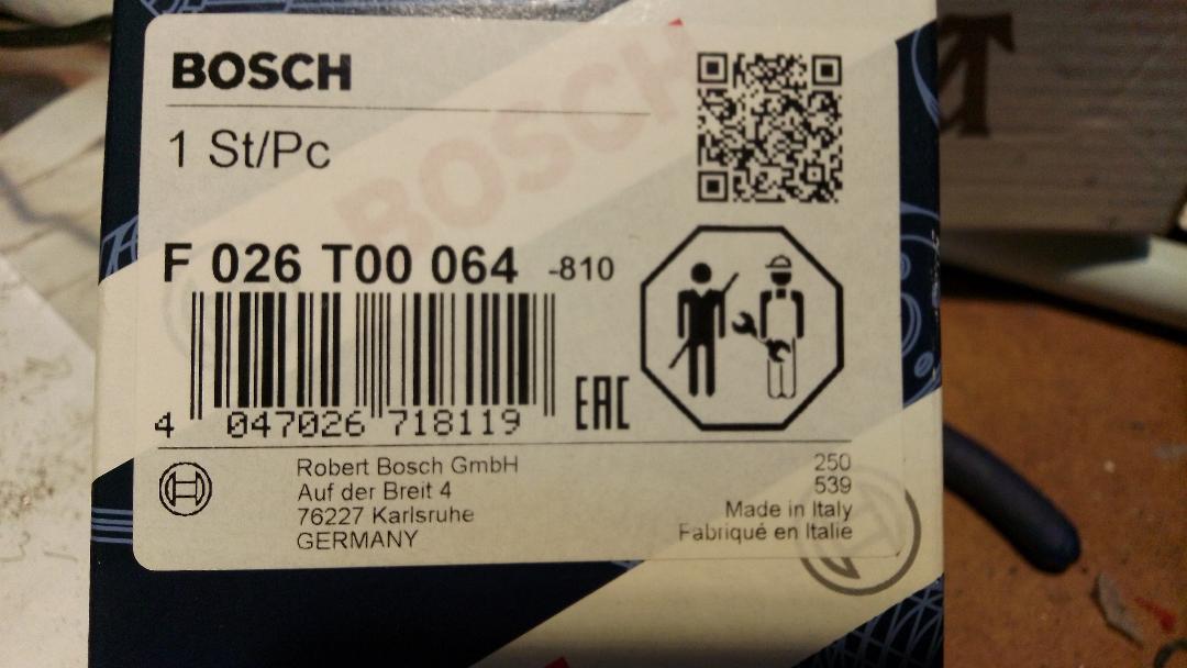

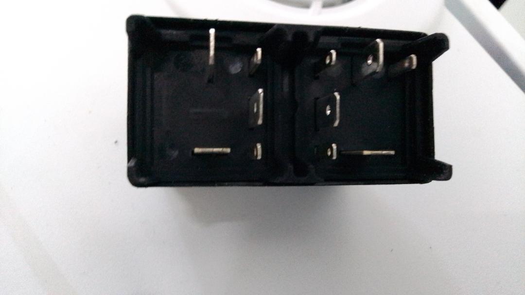

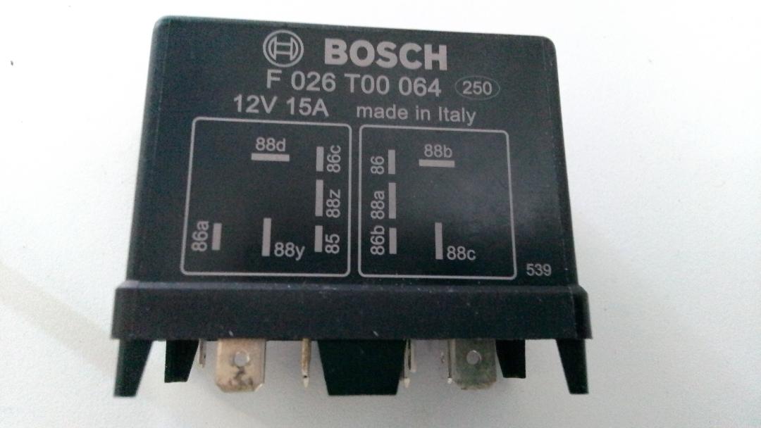

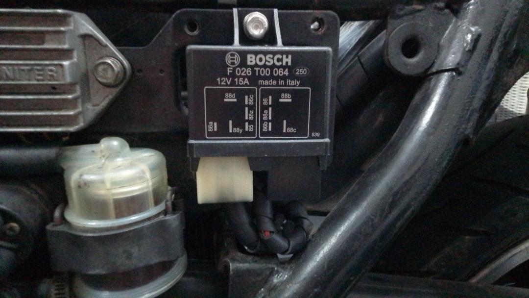

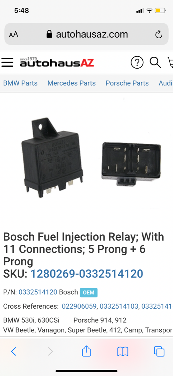

HelloWork on a friend new to him 81 gpz1100 . Had problems not turning engine nor starting . Found that the 2 in 1 Fuel pump relay was bad and lucky him we found a brand new one in a parts box he was giving with another buy.Many suggested that Bosch 332 514 120 was what many have been using so I bought as a spare.Anyone else have use this as a replacement?

Yes, that Bosch part number is correct. I bought one off of Evil-bay and installed it on my '82 GPZ1100.
