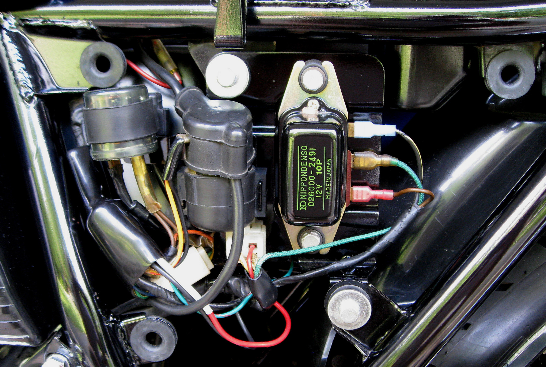

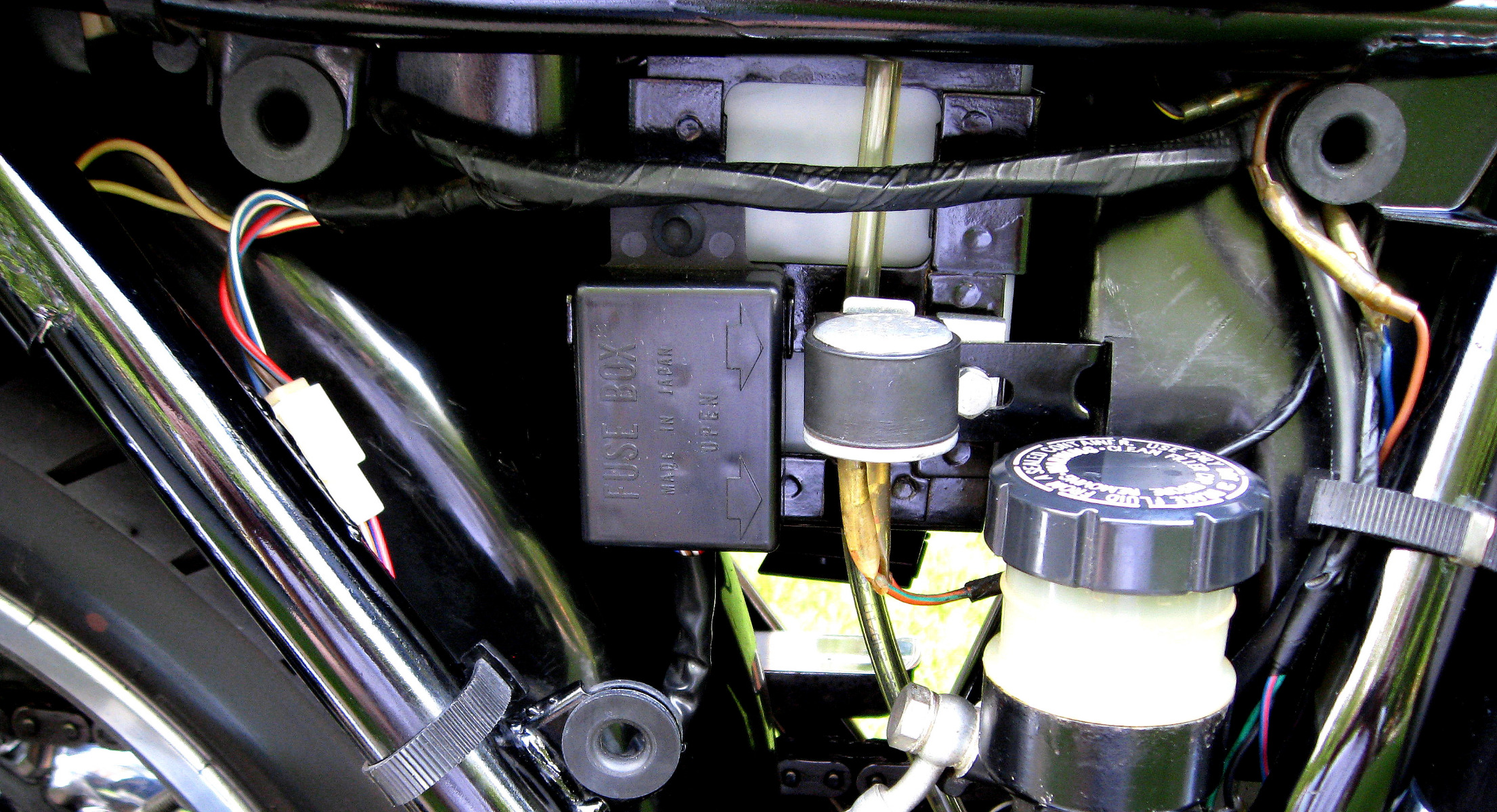

Im trying to re route as close to original as I can, after fixing my harness up, and splitting it all apart. Im also trying to figure out what goes where under the side covers and under the seat. fuse box, tail light outage relay and all kinds of other stuff... I have the ignitor and flasher relays etc sorted.... i think. would just be great to have a visual to go by. Also trying to figure out the hinge system for the seat.
