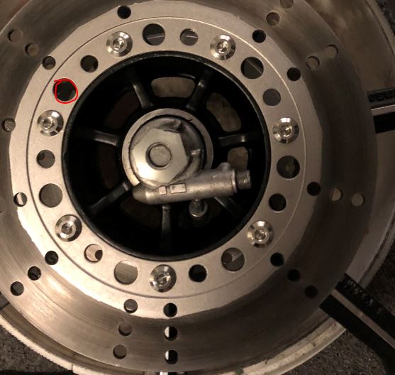

I was thinking maybe I can use some of the exsisting wholes in the disc rotor ? How many magnets do you need ?

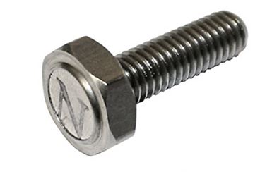

Se picture below, I see they sell Bolts with magnet included.

20 Apr 2021 00:21Put the magnets into head of your seven rotor bolts and you are fine. So more impulse per wheel rotation, so more accurate your speedo/tach will work!!!
