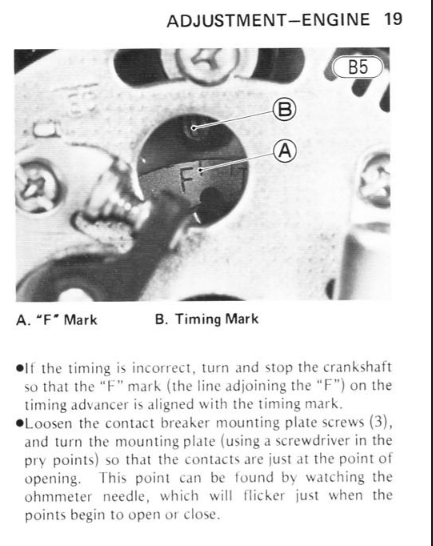

You are running points so it's not too much different than a honda.
You need to make sure the points are opening a the "F" mark on the timing plate.
bike turned off
Put your meter on resistance.
put a probe on each ignition point
rotate the crank counter-clockwise till the F mark lines up on the pointer
look at your meter to verify the points open at that moment.
