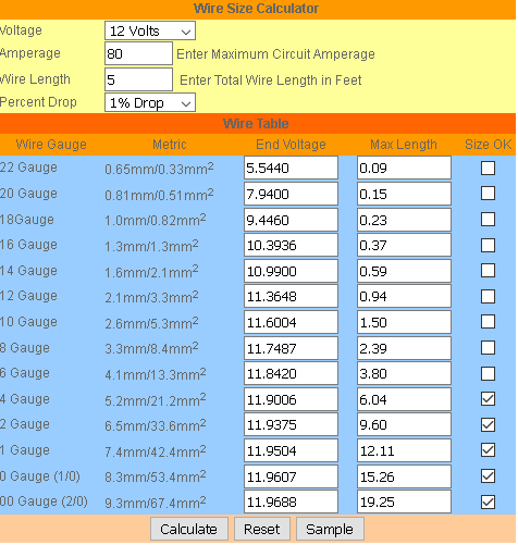

I would increase your wire size first. I think my starter pulls 80amps at 12V.
With that amperage...12V 4ft. A 1% voltage drop requires 4awg.
The stock bike is not 4awg. It may be closer to 12awg which is a 6% drop.
Size your wires correctly then add the supercap if you need it.
Your ground wire to the frame should be 4awg as well.

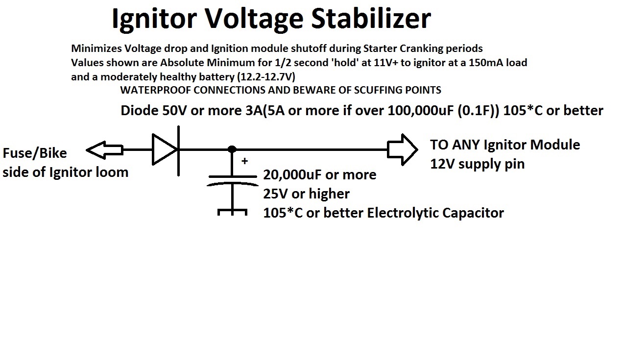

It's the HV circuid that dies rapidly.Here's a circuit that I have driving/floating my TCI/Ignitor on my '95 1100 Yami VIRAGO Their TCI shuts itself off below 10V !?!! Pionts/Condensor would need higher capacitance(More Joules/Culombs), but the 'Stick Diagram' circuit should provide a stable 12V Float time during start...Again, new to Kawi but the physics is the same...
