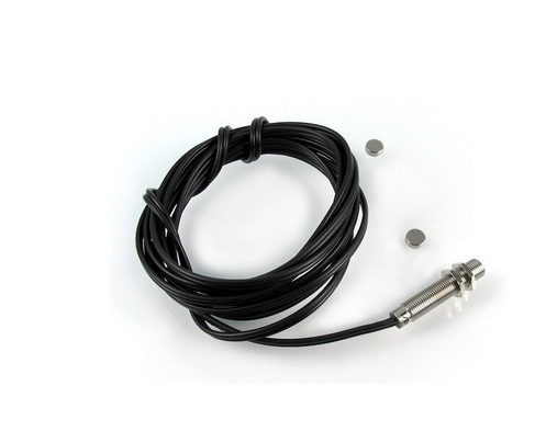

It depends on what the sensor pickup looks like.
I would probably mount the pickup under the swingarm and mount the magnet on the edge of the rim with epoxy.

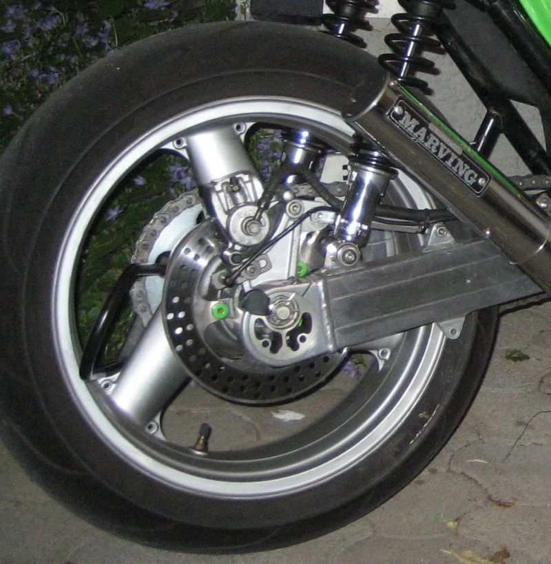

Have you considered mounting the sensor near the output sprocket on the engine? I've seen examples of this. That seems easier to mount the sensor much closer to the magnet (I assuming you're talking about a magnet sensor). I wonder if you could also do it with a coil type sensor using the sprocket teeth?

A little difficult to see, my activ speed sensor set up. A passiv sensor need neodym magnets in the break rotor bolts.
