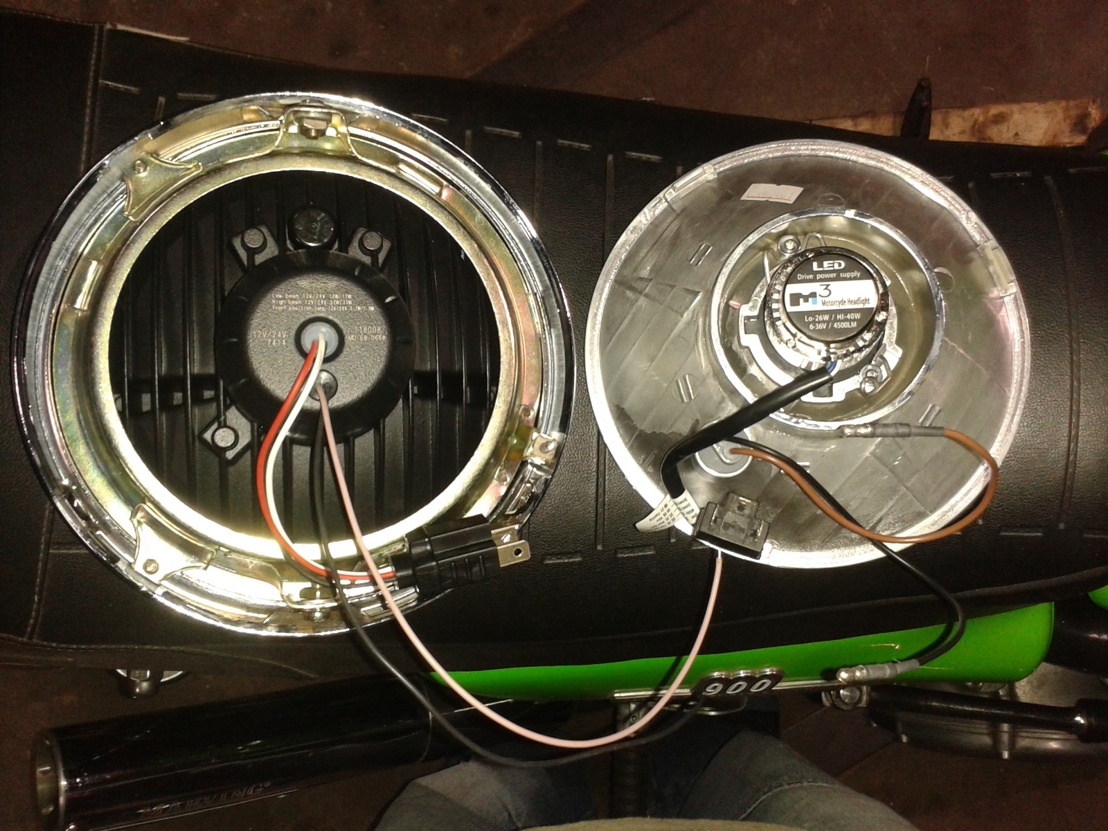

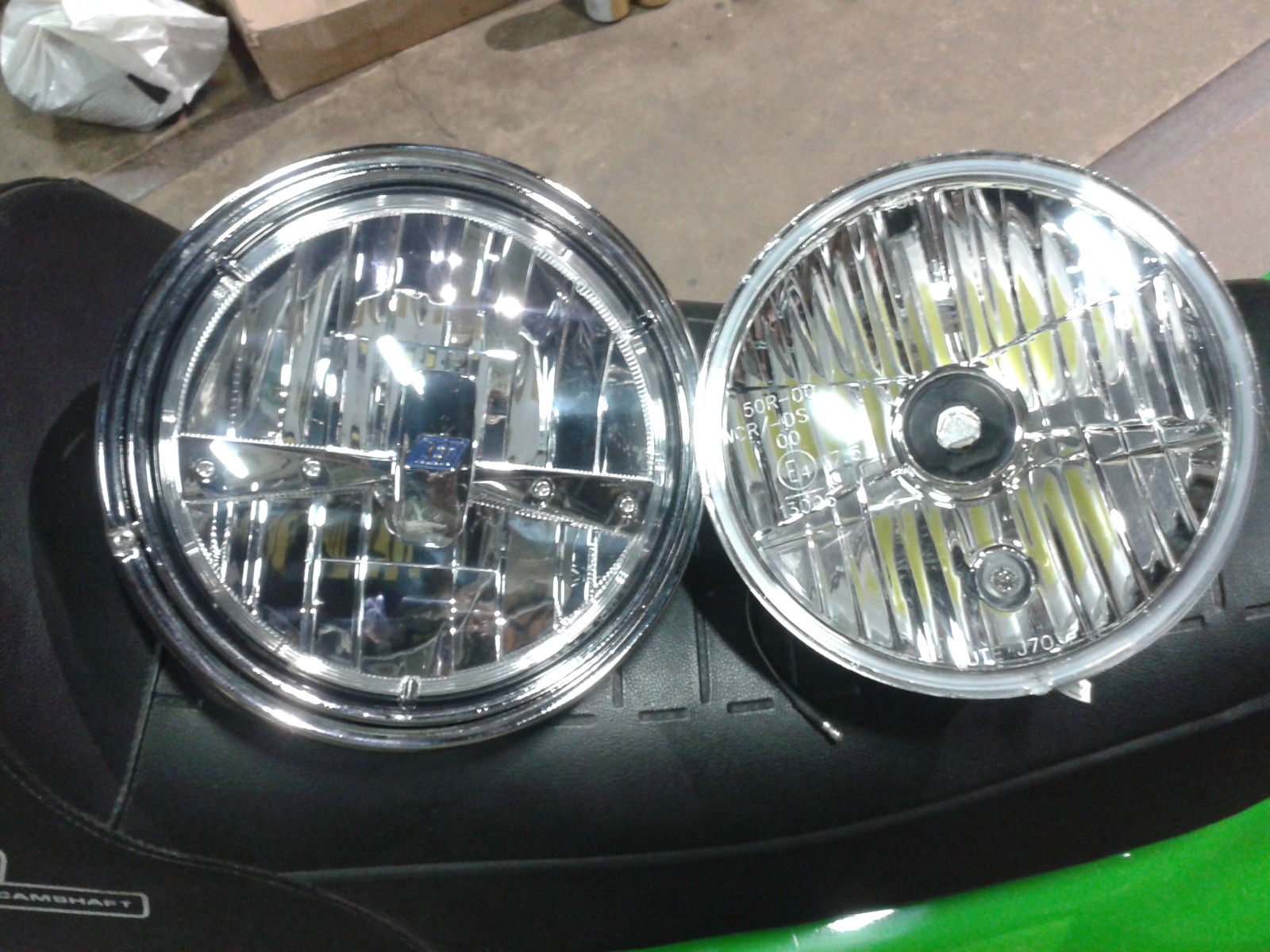

Yes, PO = Position Light. A small 12 Volt 5 Watts bulb is added in the base of the head light reflector.
