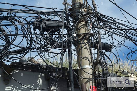

The Chinese are geniuses when it comes to electrical stuff, otherwise they would be confused by how they wire stuff. The image below from Beijing is proof positive. :woohoo: Ed
